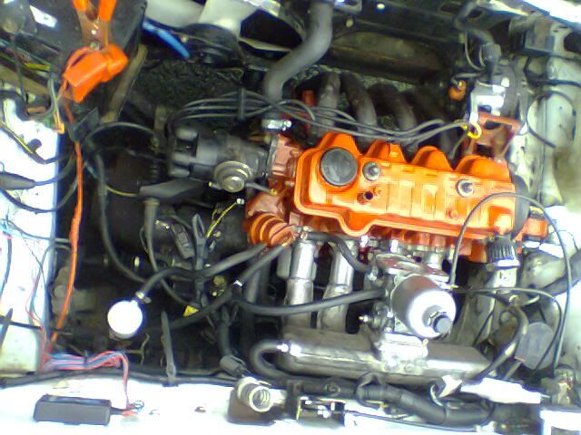

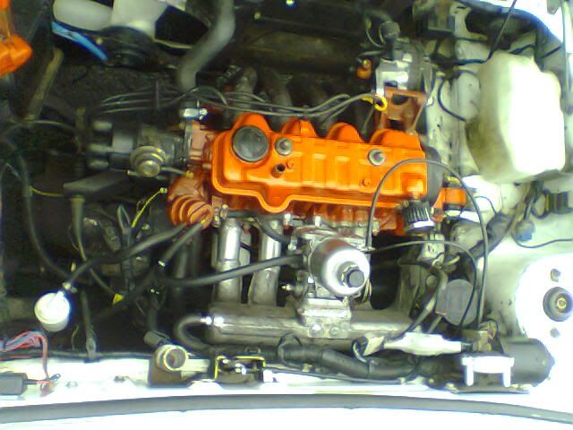

I finally went along and fitted my manifold and new carb today, car kinda runs but dies after a few seconds, when opening the throttle the car dies instantly and can only be started by opening the choke.
before the vacumm advance hose was connected to the standard manifold and then straight to the dizzy, with this new manifold there is no where in which it connects so has to go from the carb to the dizzy, my question is will the timing be wrong? reason being is that the car starts better and idles sometimes by itself with the vacumm unattached.
and help would be appriciated. see pics and a video of what i mean.

mark blank off the advance and retard on the carb and set your timing @ 20 degrees advance @ 4000 rpm..and put a standard needle in the carb out off a metro 1300

It wont even run at the moment properly, wont idle, it just revs up then die's. Could it be the timing? hope its down to the timing.
do i set the timing with the dizzy blocked off still? but then still leave it blocked?
Mark, Bob has just told you what to do. re-read his post and do exactly as he said.
Had another go at it today, I've blocked off the vacumm on both the dizzy and the carb,

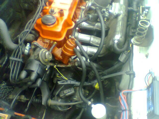

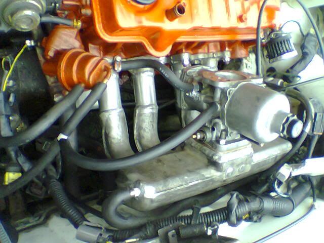

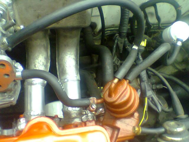

I took some pictures to show how the fuel pipes are connected, but i still cannot get it to run more than a few seconds, I advanced the timing slightly and it starts better than what it did,
any help would be appriciated,
I've also attached a Video clip so you can see what i mean. all i did was pull the choke out, I did not touch the accelerator pedal at all it dies on its own..

have you adjust the fuel mixture on the carb mark? it maybe its not getting enough fuel, very odd ive never seen a car run for a few seconds then die like that. the only thing it reminds me off is when the idle speed compensator vacuum hose is disconected.. this would stop the car ticking over with a normal hitachi carb. but then if you have blocked off the vacuum!?!... got me puzzled!
I'm going to take it off again tomorrow and fit it with new gaskets as its leaking water and burning it. i've changed the fuel return pipe as that was wrong and was actually a breather.
should run properly when its correctly sealed. I hope
It did look to me that the pipeing was not right, however I dont know those carbs so I couldn't comment.
