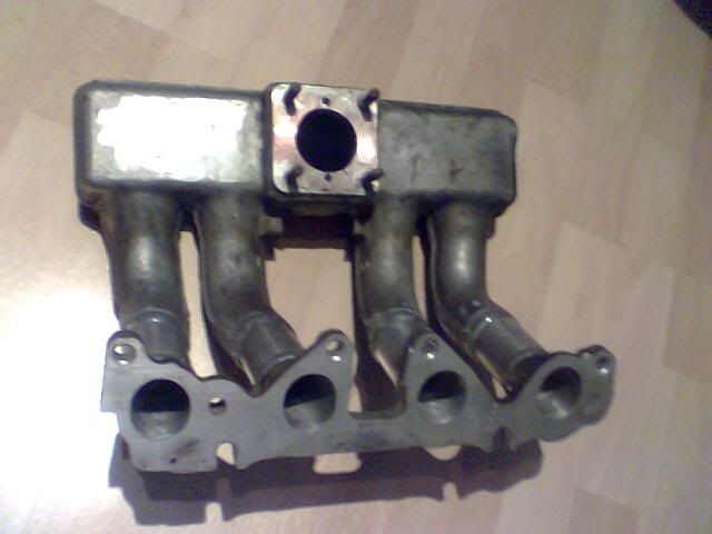

Collected my new inlet manifold today and carb, carb is a 46mm SU carb to replace my standard 32mm weber,
power gains should be huge, going to have it on the car next weekend after i get some new gaskets and then rolling roaded to be all set up :)

the inlet is indeed one of the most restrictive parts the ma12 head is not to bad on air flow but to get the best from this a bit of head work is required but on its own should yield good results iirc kev got 75bhp at the wheels from his twin webbers and they never ran right which is a shame, still the proofs in the rolling road ;)

having compared the ports on this inlet manifold to the standard inlet manifold the difference is huge, the standard ports are tiny!

i took the inlet manifold off my 1.2 yesterday and can honestly say the inlet is of crap design if you want to get power out of it, its fine for 60bhp though.
the ports on the inlet are smaller than the head and dont match up correctly, the head dosent seem that bad for a 1.2, im sure the head is not a restrictive part of the engine and noone will out flow the head when tuning a N/A engine, on the other hand a turbo MA will struggle

Lads I dont mean to #### on your parade but that looks to me like a Escort RS Turbo manifold which flows like a bag of #### naturally but which isnt an issue since this manifold is usually force fed. The SU carb is old and a bit crap. Why not use a Nissan based manifold? Im not too impressed with the way the standard manifolds flange face has been grafted into place theres bound to be a restriction inside unless you extrude hone it to get rid of any imperfections.

I cannot make an inlet manifold myself in a million years so i bought the only one that was for sale, I've never seen another forsale so its not as if there widely avaliable, The SU carb came with it so that is what i will use, the manifold is off a class 2 autograss race car so has been used before and compared to the standard manifold it is a vast improvement.
inside where it has been welded has been smoothed out and there is no restriction
if you saw the standard manifold chap you would think the rs turbo manifold flowed like a fine wine at an italian restaurant lol the standard inlet is like trying to drink a thick milkshake through the worlds smallest straw lol. it is the most restrictive part of the cars system, but then saying that its also what makes the car economical....
It may have a #### flow for an 132+tunned bhp rs turbo but for a 60bhp micra it make a big differents. If you think that i haven't smoothed out the inside of the inlet were its been welded together then your edited
