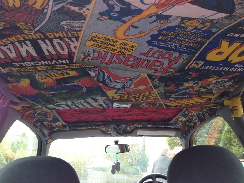

I was thinking of making a few more headliners for the k11,
Anyone want either a headliner or set off door cards covering ?
JonnyZombie's thread with the headliner and door cards, done by me

I'd love some marvel ones like that in the blue I have for your car, you should definitely produce them (Y)

well i was thinking of making a pokemon one next then just some plain colour ones to match peoples cars.
Oh and a fe black ones cos everyone like black
