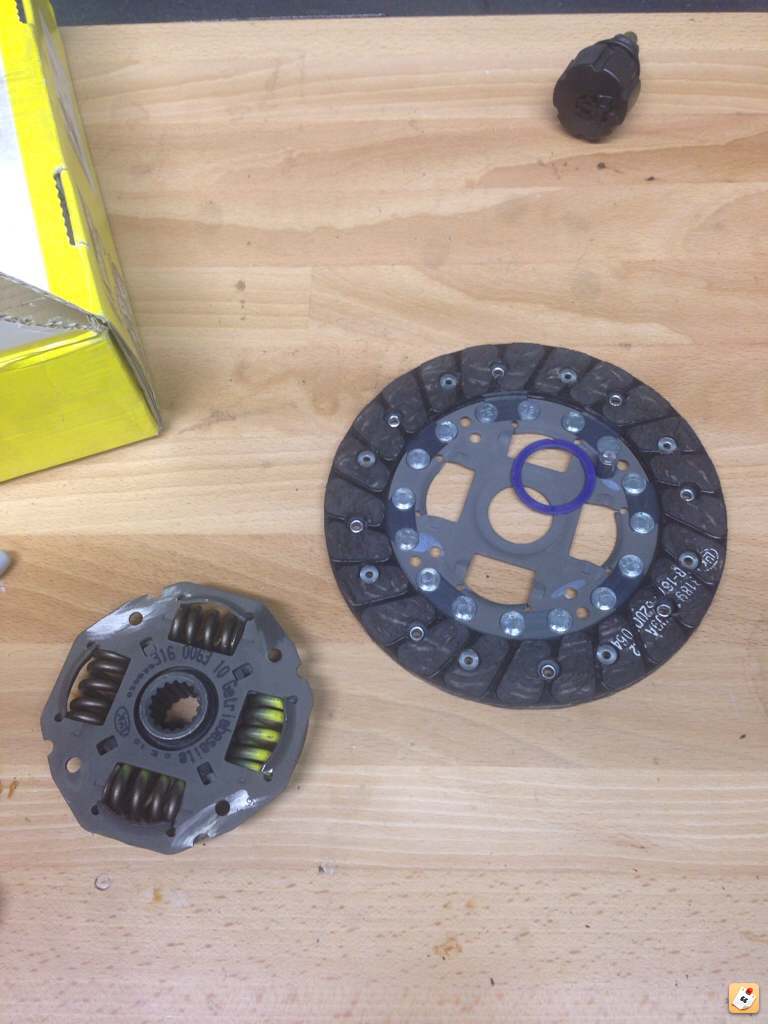

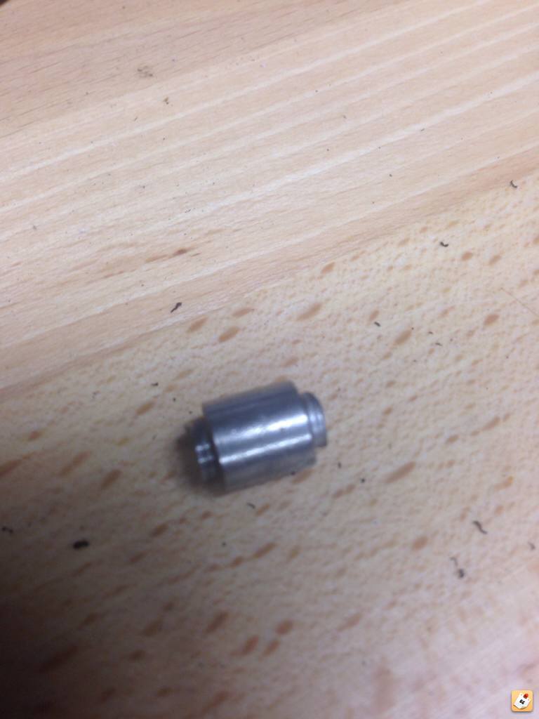

So I'm this far now.
I jus ground the heads of both sides of the rivets so
Could I jus weld a blob either side of this......
To stick it all back together? Or should I drill it out and use nut n bolts?
bolts and nyloc,s ideally neil, i sharpened a 6mm masonry drill personally (that driveplate is spring steel eh )
Cheers mate, thought this would be complicated but it's pretty simple to do ain't it :)
aye :) i slid the plate onto a shaft, and let it rotate while grinding the beveled edge neil, and i took a lick off the inside of the cover housing too
I'm to heavy handed to get things precise like that, I'm a fix it with hammers type if guy.....so bloke over the road has got it on a lathe ;)
