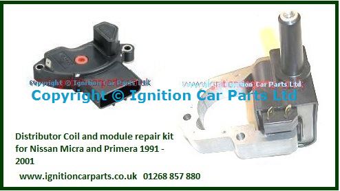

hey, I found that the ignition coil of the P11 Primera 1.6 from 96 to 2001 also fits micras distributors.
it seems there's less demand for them compared to micras, so that means lower prices. I found one cheap but the guy is asking how many pins the distributor has...
can anyone confirm how many? I guess it's five?
8 pins in total eh, a 6 pin plug and a 2 pin one
