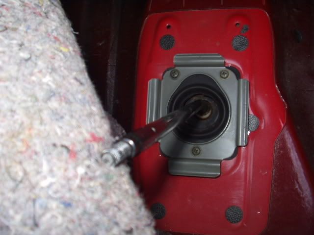

Does anyone have any photos of the Space under the front centre console when removed. (it's the one with the 5 tier Gaiter) I'd like to know what to expect when cutting the carpet and when fitting. Haynes does show the centre console but it's the small one and not the long one although they do explain how to remove and replace the long one but without pics when you need it the most.
hope you can help :)
TIA :)
My car didn't have the gearstick plastic or rubber bit, i just put one on top of the carpet and screwed it in (the holes are pre drilled into the car). You shouldn't need to cut the carpet :)
ah, i see now, thanks arnold :) Glad i dont have to cut the carpet..phew! and i've still got those little fat screws...yay! :laugh:

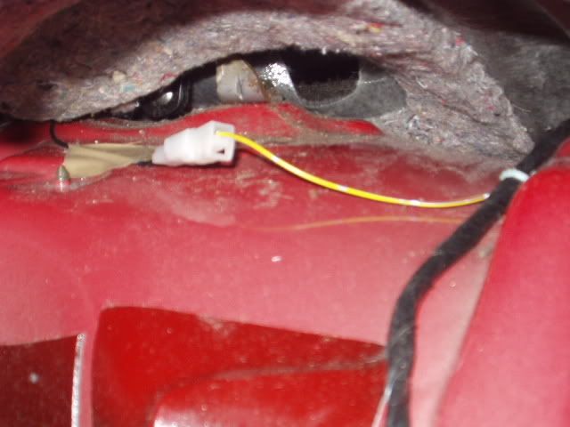

Ok, so i took out the Drivers seat, pulled up the Carpet and guess what? No Wires for the Clock :doh:
This is the only wire that's in attendance, this wire is for the Handbrake Switch. There are no other wires along that particular Wiring loom.
As for the fitting of the console, 2 Screws go in the 2 front Holes as in the pic below.

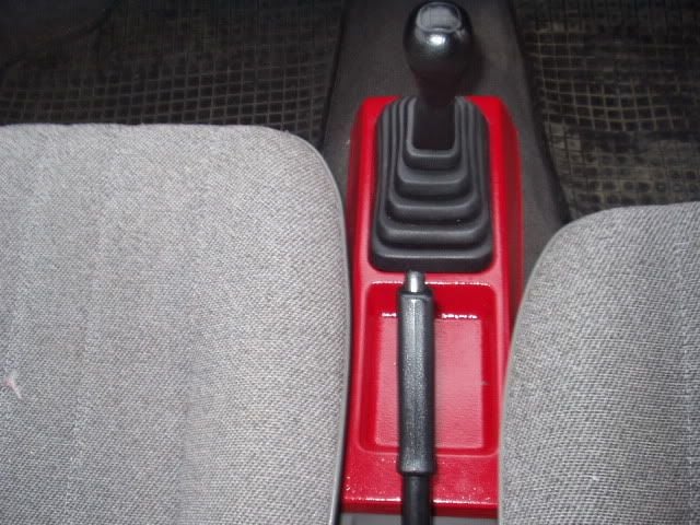

Console is now in place....the Clock will have to wait a little longer.
......and so there you have it..... :)
what? it werent there? mine was taped up to the bunch of cables wrapped in black (in first photo). Just down abit from where you photographed! On the floor of the car!
will take a pic of the clock in, when i get chance!
Ive got a photo somewhere of when i pulled my car to pieces. it's definitly there!
Old school....Looks good! (Y)

In the Haynes manual, Electrical section (14.26), it states that the clock wiring only goes up to 1990, perhaps that is the reason why the Clock loom isn't there.
I still can't believe this is real......:(
They must've put the wrong loom in mine then...i so do fancy giving a Chinese burn to whoever it was who forgot to put it in! Gaaah!
I think some of those wires go across to the passenger side and power the electrical box under the passenger seat? Maybe they tied it there? although i can't imagine they would have done.
I do have that Electrical box under the seat, i shall have a 'feel' first before pulling up the Carpet again....missus has got the Car at the moment so i can't have a look...
