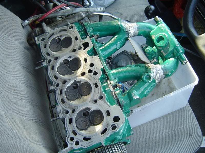

yeah and minis are lighter, half way through fitting a su 1 3/4 with head work skimmed, ported, 3 angle valves, 4-1 exhaust manifold straight exhaust system and denso platinuim plugs.
Will be having a mini speacialists to set it up and rolling roaded in june, possibly with a mad cam.
Had it running breifly but the inlet manifold didn't sela on the head quite properly and pumped a small amount of water into the cylinders, didn't do any damage but stripped down anyway.

Whipit, Is that a RAM pipe!!!
Ar you gonna use the Mini Air filter and Box or going for a pankake?
Yeah thats a ram pipe and a ITG sock filter just pushes on over that, no air box or pancake. That 4-1 manifold is great and yes i have been looking into twin SU's and will have a manifold tigged up later on in the year once i understand the carbs a bit more.
