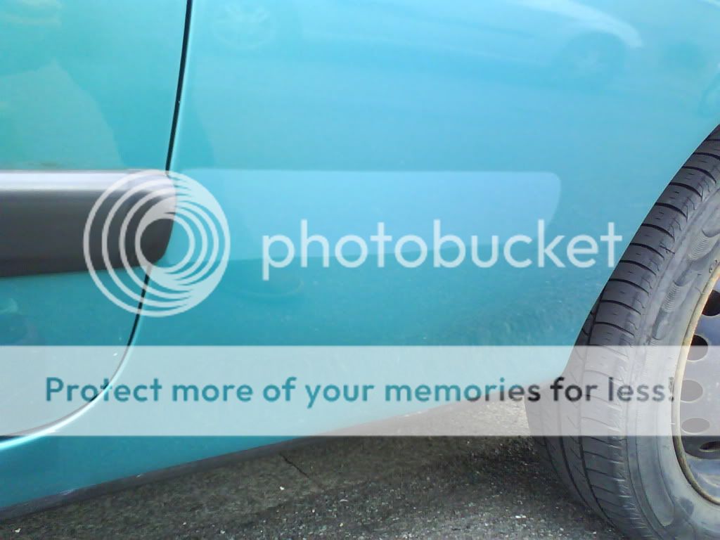

So yesterday i decided to pull my finger out and start removing my bump strips.
I started with the little one on the rear wing 'cause of all the horror stories about them taking paint off etc..
It came off easily enough but the paint underneath is a fair bit lighter and t-cut doesnt seem to be touching it tbh. The paint underneath does seem to be at a lower level to the paint around it (if that makes sense) and theres a bit of a ridge where the two areas meet.
I've taken a pic (sorry rubbish quality) of what it looks like..
any ideas please? i dont want bumpstrips :(
looks like the car might have been resprayed, there shouldn't be a lip
T-cut should at least take the lip off, its hard work but keep going
other than that you can try and paint it, find some paint that matches.

hmmm was afraid of that
i really cant be dealing with painting as that just opens up the possibility for even more stuff to go wrong.
I might look into colour coding, but if it has been reprayed, ive got a feeling colour matching will be hard
Cheers anyway
You'll be there a month of Sundays with T cut,looks like you've got 2 coats of laquer to flat out...Use 1200 wet & dry with soapy water and a flat block being careful not to burn through.You can blow the offending area in after with laquer after which will not be perfect but may well dull the bright green area a little.
Cheers anyway

grr i dont know what to do now, will probabaly end up just putting it back on and not bothering with the rest :(

Yeah lol but wouldnt solve the miss-match on my rear panels, and havent even started on the door strips yet cause im sure they'll be the same

I bet you could hide that could enough by putting some aerosol laquer over the offending are.
Don't give up!Have a look at the other panels on the car,you can always find evidence of repairs so you'll know if removal of strips is a problem all round the car..

thats a point, it might only be that side thats been painted, so at least you can take the others off or something
