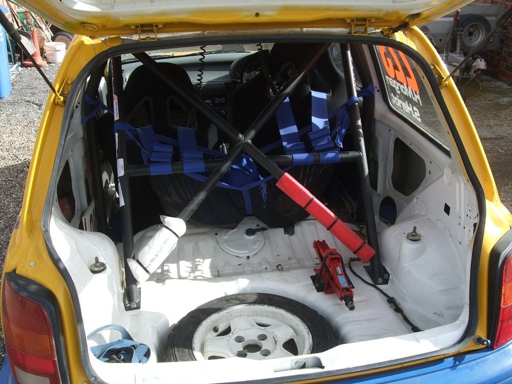

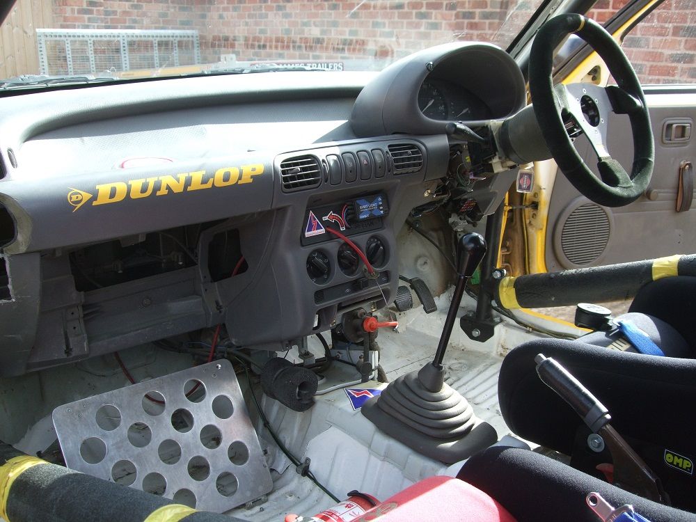

Hi All,
Just a bit of a tester to see if i could upload photos
These are just some photos of my 1.0l Forest car before strip down, I will get you some photos photos of some of the bits and bobs I've bought and the work I've been doing over the last 2-3 weeks
Thanks for looking H

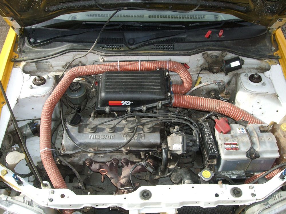

To give you an idea of what I'm playing with at the moment :)

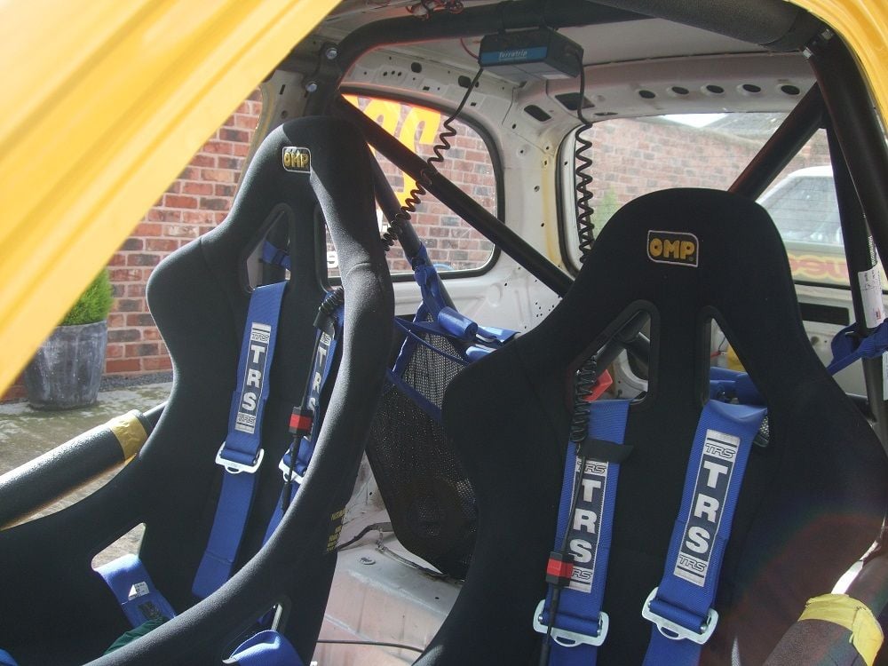

Car Spec as of now:
Rally First 1.0L Nissan Micra, N824 XNP, Has been running in the BTRDA rally first class over the last 2-3 years competing in 11 rallies, taking consistent top 3 finishes, before then competing on single venue tarmac events by previous owner.
Shell
3 door very strong and solid 1995 K11 shell, no sunroof, full Safety Devices 6 point bolt in cage (2 years old), lightened bonnet and boot, fitted with heavy duty aluminium front sump guard, heavy duty aluminium rear tank guard (fitted new two rallies ago), high tensile plastic guarding to cover brake and fuel lines and rear suspension and brakes, plumbed in 2.25l fire extinguisher and 1.75l handheld extinguisher (both recently tested), Sparco navigators footrest, OMP Evo Seats (out of date next year), TRS Magnum 5 point belts (FIA end 2015), OMP WRC suede steering wheel and boss, TRS helmet net, complete dash with heater, all windows fitted with safety film.
Engine & Transmission
Standard '95 engine, complete engine rebuild, OMEX shift light pro, new fuel and oil filters, Fuchs Titan race oil (2 rallies ago), standard airbox modified with twin air inlet pipes and K and N element filter, earlier 98 gearbox fitted with better gear ratios, larger input, bigger clutch and flywheel and bigger drive shafts (new 2 rallies ago), new clutch and throttle cables, Ashley competition exhaust with Power-flex mounts, new fuel pump.
Suspension and Brakes
Full Ex Micra Challenge Bilstein suspension, complete front Mcpherson struts with Eibach springs, forest helper springs, heavy duty roller top mounts, rear Bilstein challenge shocks, rear Eibach forest springs, strengthened panard rod, standard brake setup with Mintex discs, pads and rear shoes, new rear brake pistons and handbrake cable.
Wheels and Tyres

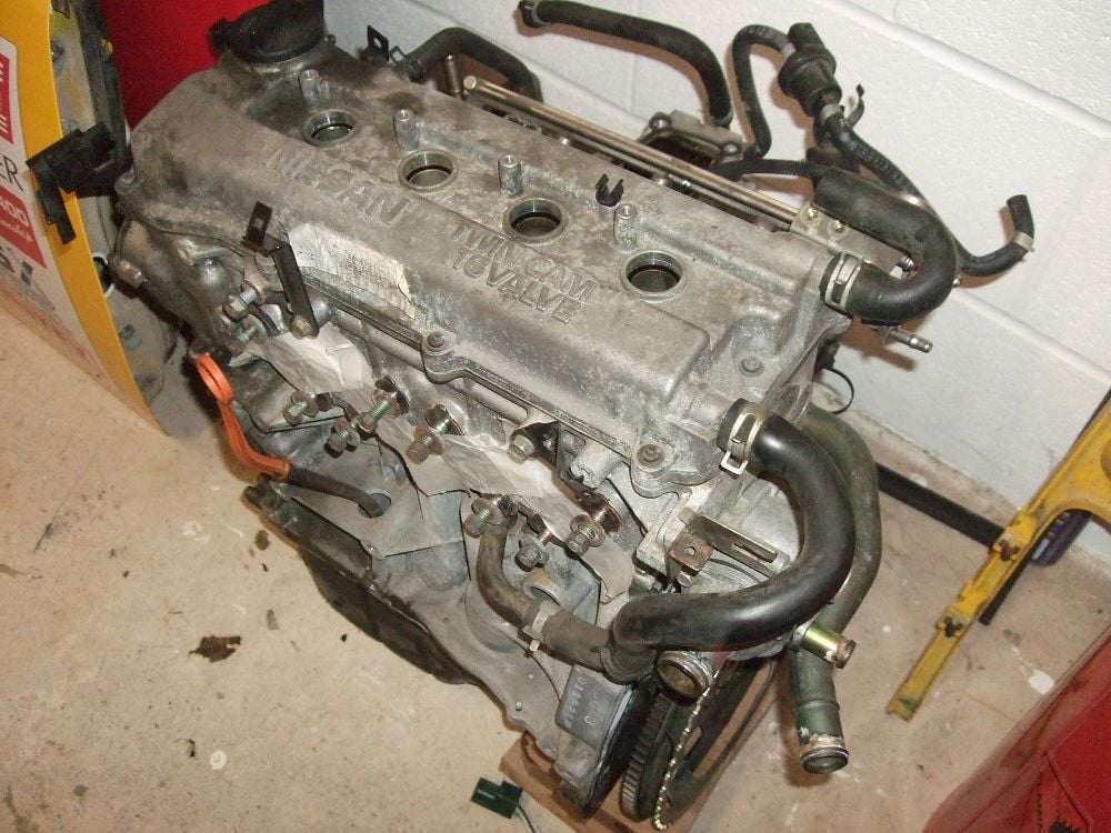

Few more photos of bits I've managed to collect for my big project.

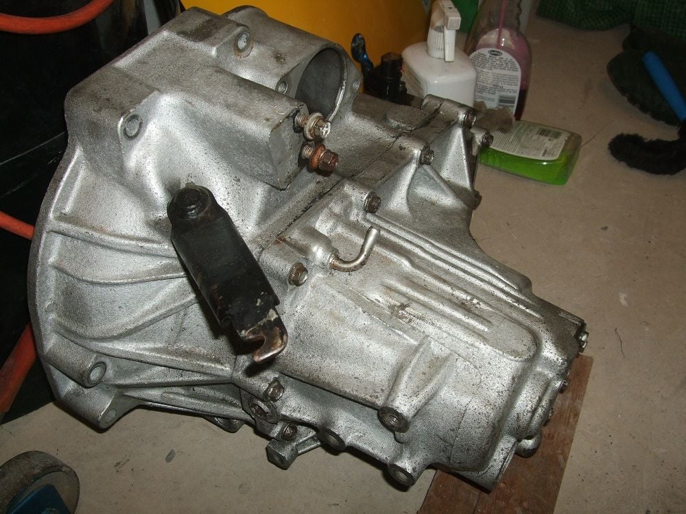

  • CGA3 Engine, Auto 50,000 miles
  • 1.3 Gearbox with Gripper Diff and 5.1 C&P fitted

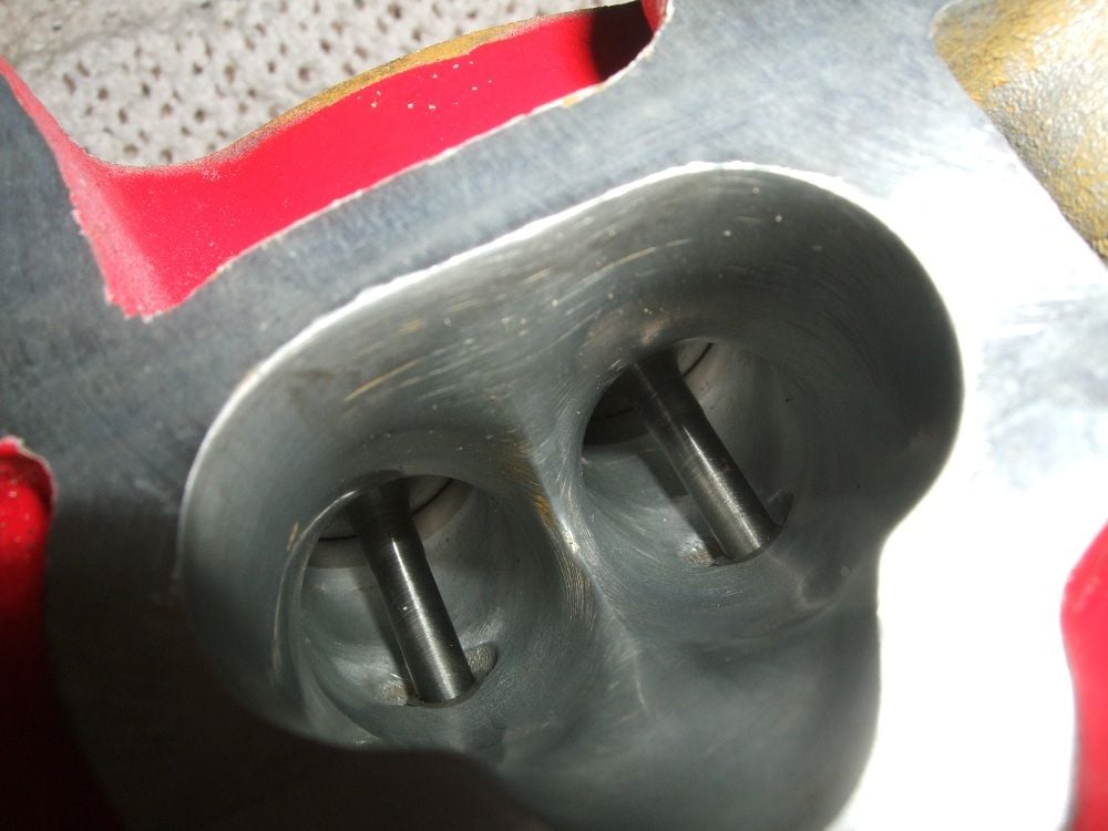

  • Polished and Ported Dizzy Head

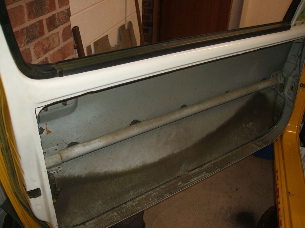

  • Made a bit of a start on these lightened doors.
Hi Gents,
Skinner_87 Was the Omex shift light difficult to fit? No it was pretty easy actually, once i found the yellow and green wire under the dash, just hooked into that for the revs and the the interior light power supply cable, the shify light comes with a easy to follow guide anyway, then they just provide sticky back pads to fit it where you like, found it brilliant for my forest car especially as you doing realise you are sitting of the limiter with all the gravel underneath the car.
reflexuk Can you still lock it's doors Charlie?
You can still lock the doors Yes, same as before from the outside, but from the inside you just flick down the leaver down on the mechanisium, amazed how much weight i have managed to save after just taking that bit out.
How do you attach a doorcard to that door now?
The thing is I'm not planning too, they weight too much for one, and two, to neaten up the whole door all I need is some of this http://www.demon-tweeks.co.uk/motor...-seals/demon-tweeks-titanfast-pvc-edging-trim just get it off ebay or something much cheaper.
Regards Harry

So how do you open the door from sat inside now?
As Stani1029 has said, if I tie string to the opening mechanism then about half way down the door, when pulled the door will open. As I go I will upload some photos to show you how I'll do it.

Lowrider................ I'm unsure on this lightened door or a standard one, there is alot more i could take out these doors yet, only thing is it starts to loose its rigidity and the only reason I have left the impact bar in the door is due to only having single door bars on the roll cage, I know some lads with double door bars on the roll cage can get away with taking this impact bar out, or pure tarmac lads, as side swiping trees doesnt fair well when you have a sheet of tin between you and the tree trunk :eek:
Skinner................. yes the sideones are, unsure about the rear one as its formed but i'd say its around 4mm thick.
Yeah, I know what you mean. Trees don't tend to move when you hit them......if I were rallying I would have double door bars without a thought. I have single door bars at the front and have not done anything to the doors yet but have some ideas in the pipeline to dump some weight out of the car. Since we will only be using the car on the race track, we can probably get away with a fair bit more.
The weight of a standard door un-lightened, with OEM glass, window winder, trims etc would be a great datum to start with.

Seat rails all in and looking good and general tidy up of the interior,

So Far, Fully Stripped the CGA3 down and have just sent the block, Crank, Rods and nice new accrulite forged pistons to C.M.A in Chester who can carry out engine machining, for it to have a slight rebore, balance the crank and rods and lighten and balance the fly.

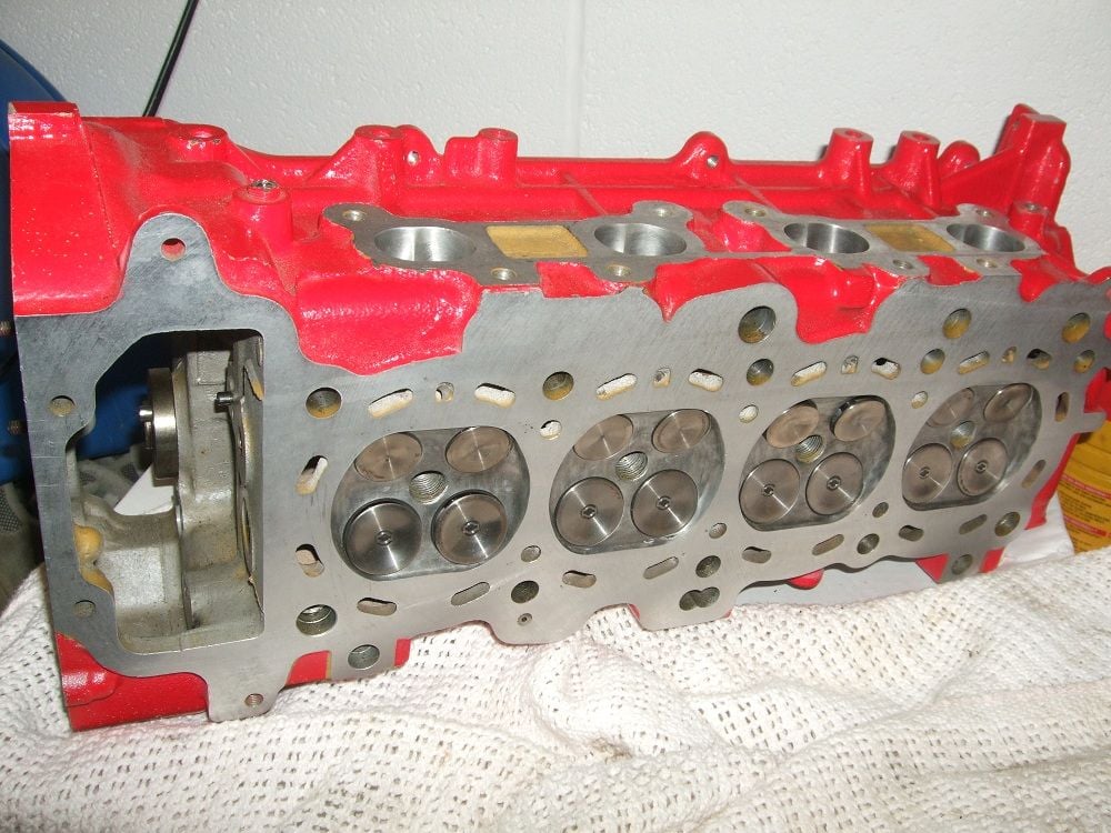

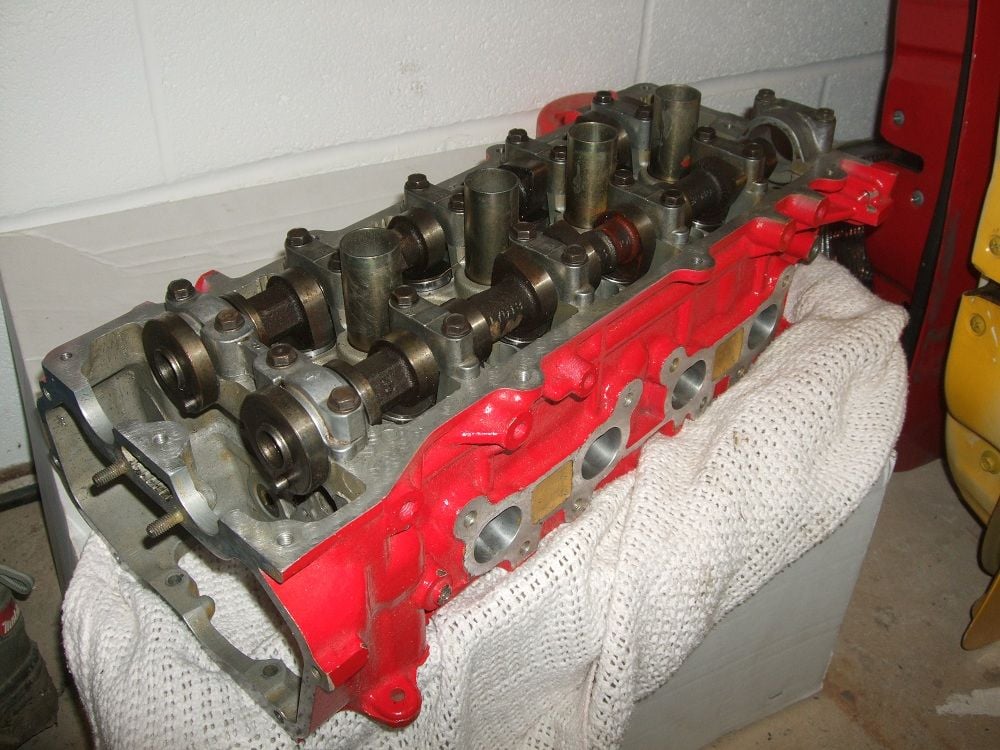

Ladies and Gents its been a long while but finally making a headway to building this engine back up,
First question.
I have a CG13 and CGA3 cylinder head, and I'm just about to fit my nice new 773 cams, and noticed the followers are different, CGA3's are solid followers, what should I use for a 773 cam setup?
Will upload some photos of the build stages.
Many Thanks Harry

CG13 is a 1275
CGA3 is a 1348
CG13 has a Distributor or coil pack head.
Where as the CGA3 is a coil pack head.
What I've got is a CG13 Distributor head that I want to fit to the CGA3 block for ease of tuning, but just wondering whether its possible to move the solid cam followers from the removed CGA3 head into my CG13 dizzy head to then setup the 773 cams
some CGA3 followers/buckets are shimless harry (same ones as the later CR engines) they are graded in thickness tho, and if the clearance is out of spec you have to select or buy the correct thickness one.
the valves are 2mm longer on those, so you can utilise that difference when using reground cams
Thanks for the info frank brilliant, so the 2mm longer valves will work better with the 773 cams fitted? as long as the clearances on the CGA3 followers are ok

New engine all built up internals wise taken me a steady 10 months lol, Managed to sort out the cam timing of the group A cams, Just waiting for my uprated injectors to be ultrasonically cleaned then will rebuild my inlet manifold also have my Ashley manifold to go on which needs heat wrapping.
