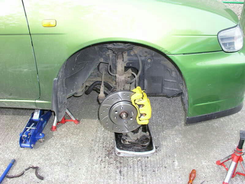

FYI, ad22vf front and stock rear calipers gives 70/30 static bias.

I know this is a common topic, I have searched but have come up with countless dribble and nonsense. Besides the ad22v upgrade, has anybody managed to use brake calipers from another make? Perhaps Toyota or mitsubishi as i understand corollas and maybe? fto's have the required 130mm caliper bolt spacing. Perhaps toyota Caldinas etc etc anyways, i believe there are a fair few makes with this spacing, the problem most likely being the offset of the rotors.
So has anybody got solid experience or ideas before i start researching. People want ridiculous amounts of money here for 20 year old ad22's and i cant justify that so im looking for alternatives.

any luck on the 130mm ctc calipers yet george ? i had a look around our local yards this afternoon and found very little tbh, most of the toyota ones were,nt 130mm, and even then the bolthole was very offset in relation to the disc face (ours are alongside the disc eh)
there was a late colt that looked promising (mivec ?) and an avensis 2.4D

found some nice looking lightweight alloy calipers on a prius yesterday :cool: same flat face bolt fitting as ours, and 130mm spacing

yes same bolts chris, 130mm apart (centre to centre), so you would need discs with the same face-to-face offset but about 30mm bigger dia than stock
hmm seems like a good upgrade. They lightweight? I couldnt think of what disks you could get, or how the hell you could search.
the caliper is alloy chris (tho that bracket is cast iron the same as stock) so they,re a lot lighter than sr20/gti ones
and sr20/gti discs i guess ? i forgot to measure the piston tho
