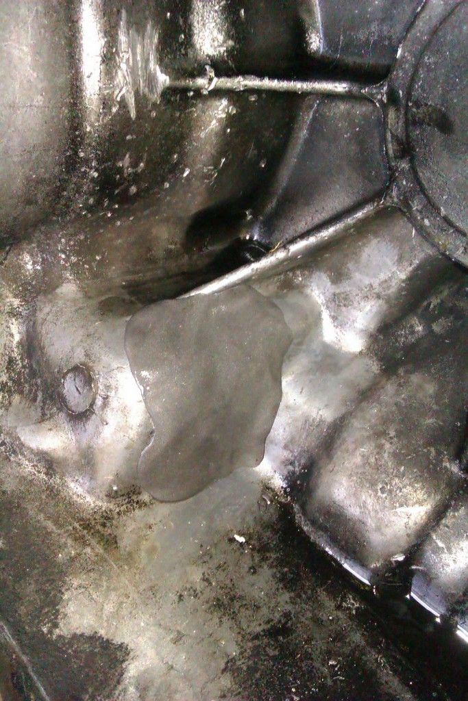

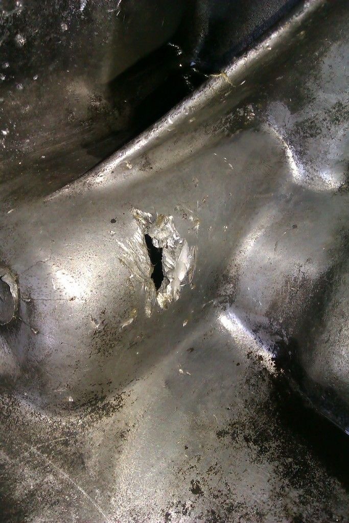

If you look at the pic though, I'm not convinced that the hole goes into the gearbox. It may just have compromised the thread.
few pics of the other side to convince u
https://www.micra.org.uk/threads/pollymobiles-rebuild.35251/page-44#post-502714
dsc05675-jpg.36759
dsc05676-jpg.36754
imho I'd get another gearbox for afew reasons:
- when the clutch blew a hole in the casing whilst still driving under load and gear oil gushing out all over the bellhousing & underside,
the very low oil level could've caused some damage to the gear teeths or bearings.
- piercing the casing would've introduced metal & dirt debris inside the gearbox. no amount of filling & draining will get all of the bits out without disassembly.
- the casing is Alu and requires TIG welding, which is more difficult, time & labour intensive so could be more expensive
- TIG requires absolute cleaniness to weld properly so the gearbox must be disassembled & degreased otherwise u risk a faulty leaky weld and get weld spatter all inside the precision gear mechanisms
- epoxy sealing putty stuff also requires absolute cleaniness/degreasing to bond properly or else it'll just leak oil again and fall out later. imo not worth the hassle or rebuying all that oil again.

Is the hole actually into one of the bolt holes that connects the gearbox to the bellhousing? Quite hard to orient yourself in those photos without the box itself infront of you! It still looks the most likely suspect for the oil draining out, if it isn't the input seal.
I know what you mean about the risks of the particles damaging the gears, but the car ran fine until I parked it (!) with no graunching or whining. When I started it to move it into the shed, the gears engaged sweetly as ever. Any fragments would probably be quite small (given how the hole was 'pecked through' by the pressure strap) and may have even be flushed out by the torrent of oil that presumably gushed forth from the breech.
Maybe that's wishful thinking!
It'll be the weekend before I get another chance to look at it. Probably pick up a crankseal on my way home from work on Friday!
Just been studying your link pollyp and staring at pictures of your gearbox (!!) - the hole does go through into a recess formed in the bellhousing for the selector mechanism, doesn't it? So I guess this hole IS where the oil came from...
yes it is neil, best to source another 98 to 2000 1.0 g/box really

Thought I might share my 'repair' photos too:
Before:
And After:
Probably not the most beautiful repair, but it seemed to set pretty damn hard and so far there's be no dripping. Car's only done a few couple-of-mile non-essential test runs so far, but it'll get a couple of proper journeys in this week.
