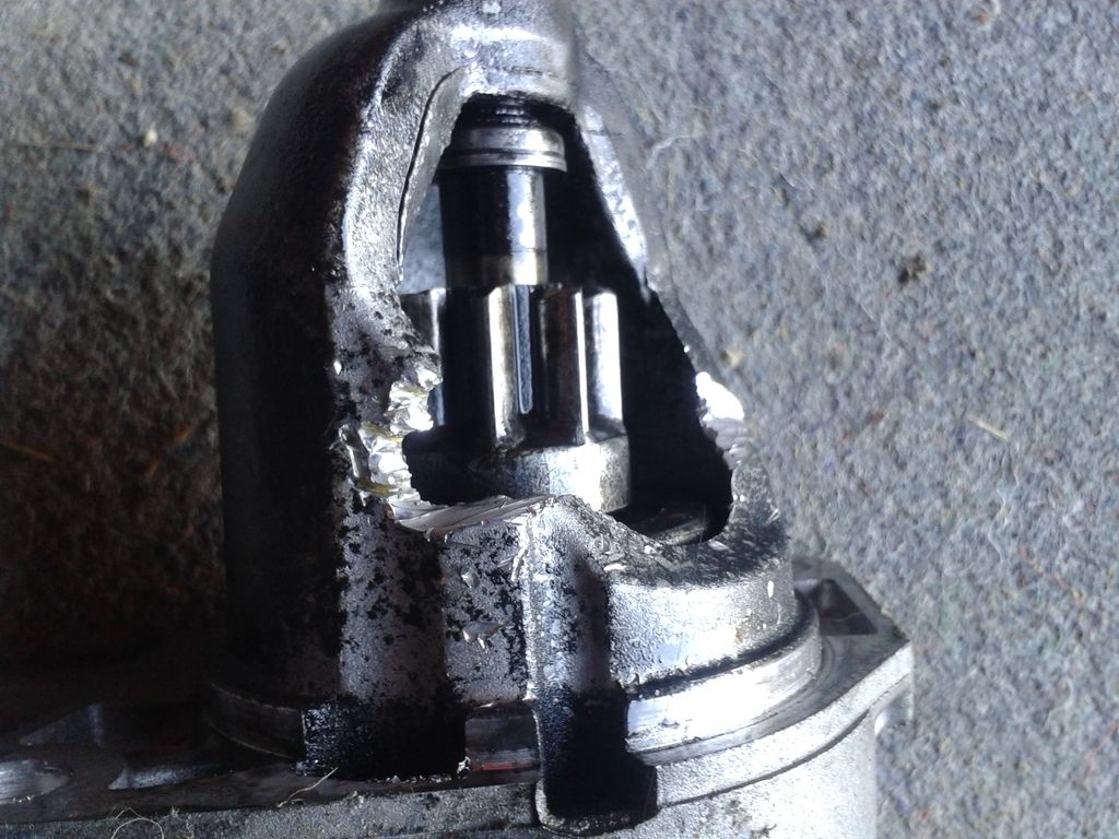

I pulled out the starter motor and found this:
The plot thickens! I've not got the gearbox off, but I'm kinda guessing something's wild and loose in the bellhousing and has probably got wrapped around the input shaft, tearing the seal...
I just can't believe I never heard a thing - car always started instantly and quietly! Must have been happening very slowly over a long period of time...
At least it means the gearbox itself is probably still good to go.

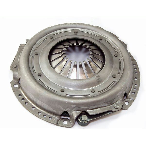

@ndndndnd This is pic of a regular pressure plate.
I'm guessing @frank means one of the metal spring straps. (Pictured), which is probably a good guess.

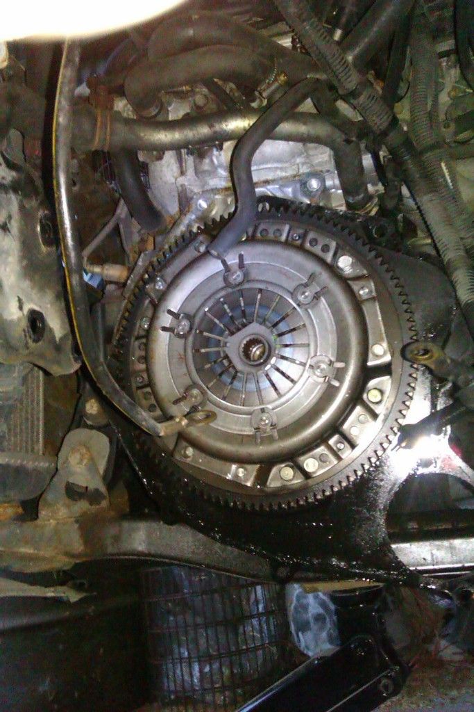

Right!

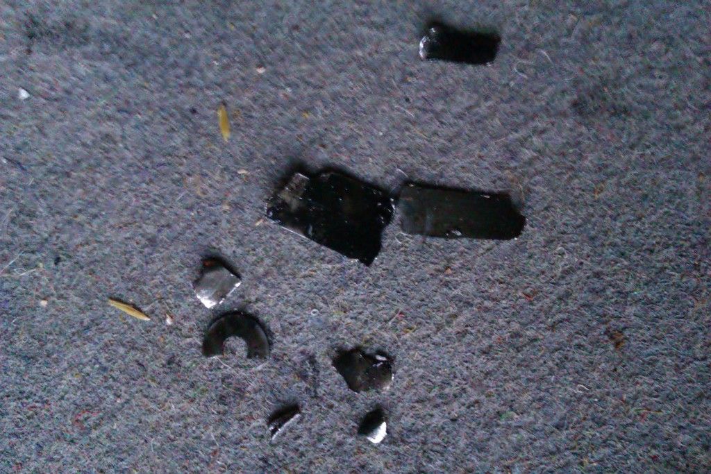

Having never taken the 'box off before, it was a complete bear of a job! Didn't get as far as changing the clutch or opening the case, but here's what fell out of the bellhousing:
Any idea what they are? Is not obvious (yet!) where they've come from...

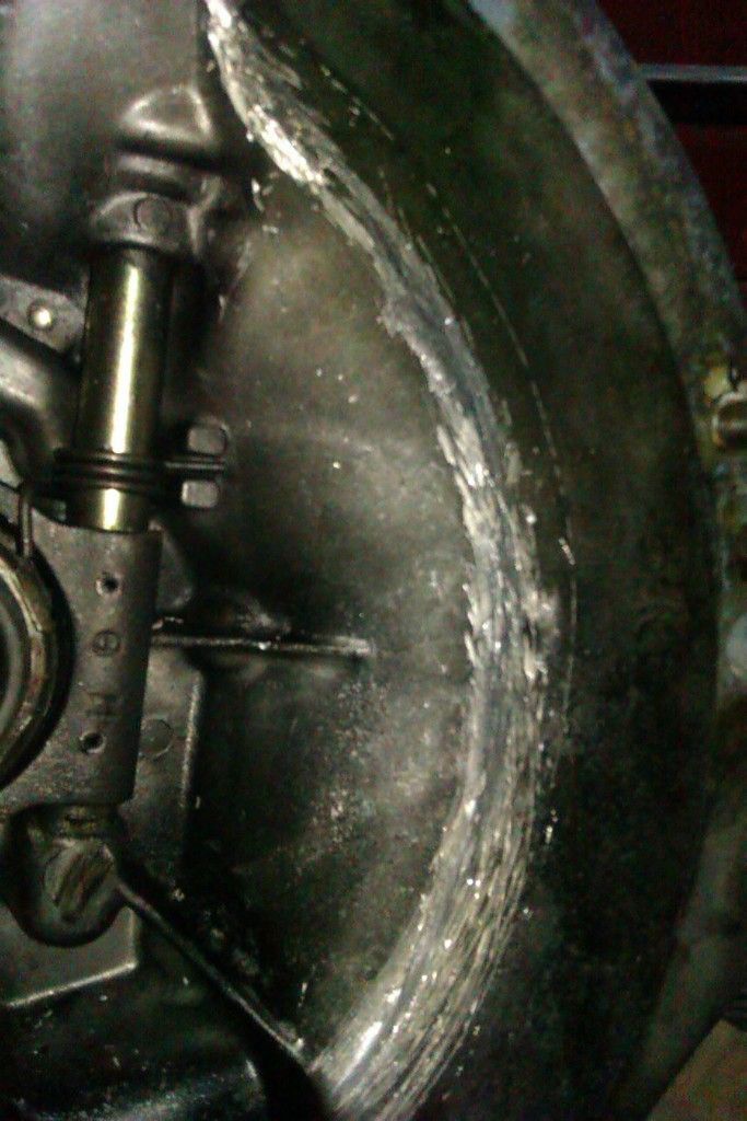

The bellhousing itself had taken a beating, scored around the circumference:
And holed here:
Is this above the selector mechanism?

I just googled what a pressure plate strap is and I'll know what to look for, although the fragments do look like one of the straps. Whatever it is has shattered to pieces inside the housing, and there's gritty, oily debris around the seal, bearing and input shaft - so that probably explains where the oil came from...
That debris does look like it could be one of the straps, meaning the Clutch is also buggered.
If the strap came loose it would have spun round and hit the bell housing.
You need to get the Clutch off and inspect it really.
Chris.

How big an issue is that hole in the bellhousing? Am I going to have to seal that up (jb weld?) before using the box again?
Erm, if its smashed a hole in the bell housing then you probably have metal inside.
For me that would be a gearbox swap, unless you want to pay to get someone to dismantle And inspect? But I know which will cost less.
Chris.
Lol. Cheese gearbox. Is that so you can play a tune on it?
And just had a look at the gearbox hole again, its close to a bolt thread so maybe it didn't get into the gearbox. But if it didn't, where did the oil get out? And was there any metal / contamination in the gearbox oil when you drained it?

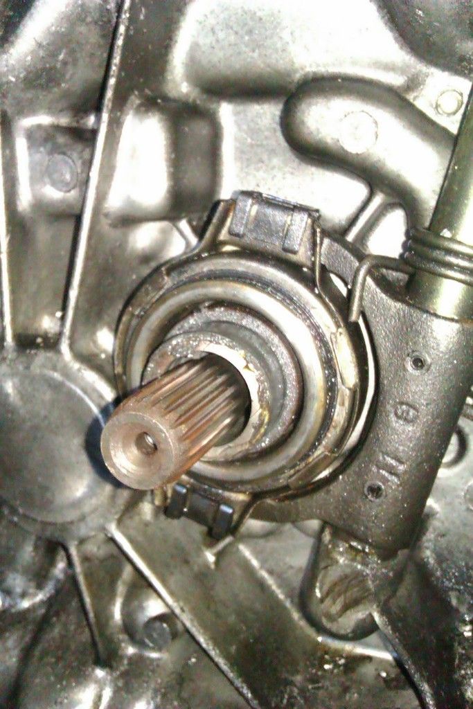

Here's the input seal:
Looking at again (whilst not knackered!) and I'm starting to doubt my version of events. I'm not convinced that input seal's actually leaking. Am I actually looking at a pressure plate strap that's broken free and whipped a hole in the bellhousing, releasing all the gearbox oil?
