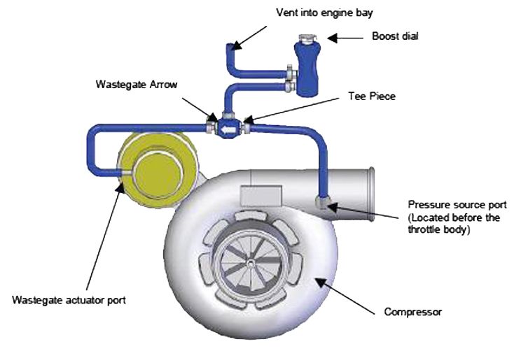

this the thing that sends boost down the pipe to actuator to open the wastegate? but i can stop it from sending boost down hence keeping wastegate closed and therefore get more boost?
effectivley keeping wastegate shut so it spools more boost?
ok cheers i understand..
should i get one? lol

yeah i was thinking that so out the log id take a pipe to the dashboard where i will mount the manual boost controller then take the pipe back to the engine bay and connect onto the actuator.
wooo bingo! im getting my head around it
this has confused me. now i thought u put the "vent into engine bay" bit to the actuator!???!?!?!
ah ok i think i understand again lol.
when the boost controller is shut the boost does not escape and therefore forces the actuator to work. If i turn that controller to open the boost is leaked out into the engine bay and therefore not enough pressure to open the actuator?
so with a block just before the tee peice i have one hose from block to the tea piece and carry on the installation like that?
and the boost source is what ive got on intake pipe a hose coming off that going somewhere lol thats my input source yeah?
