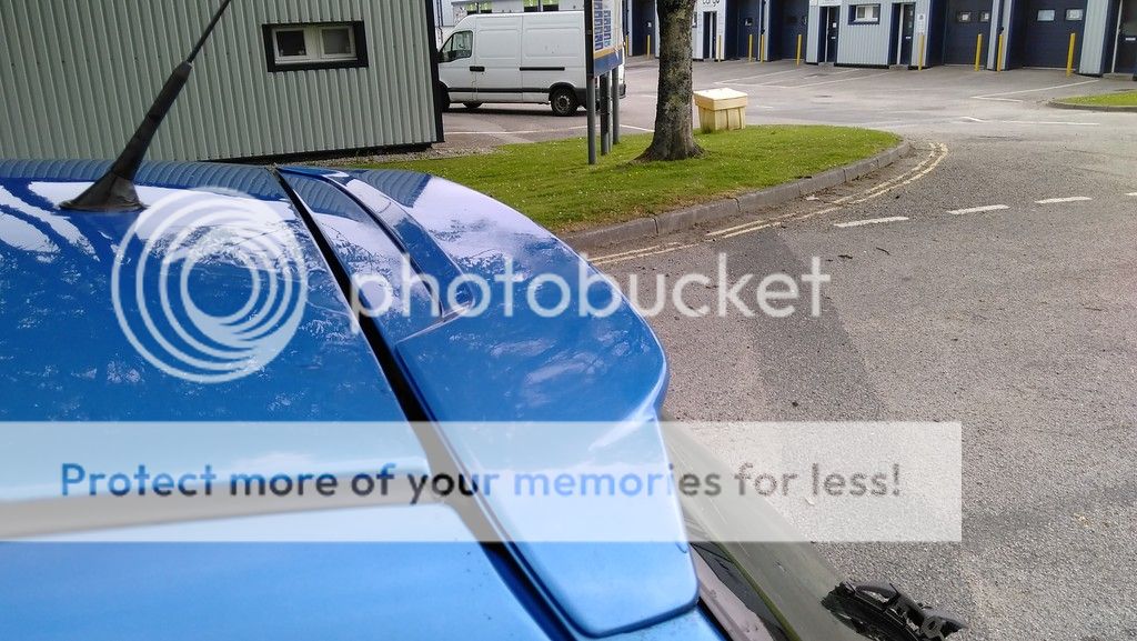

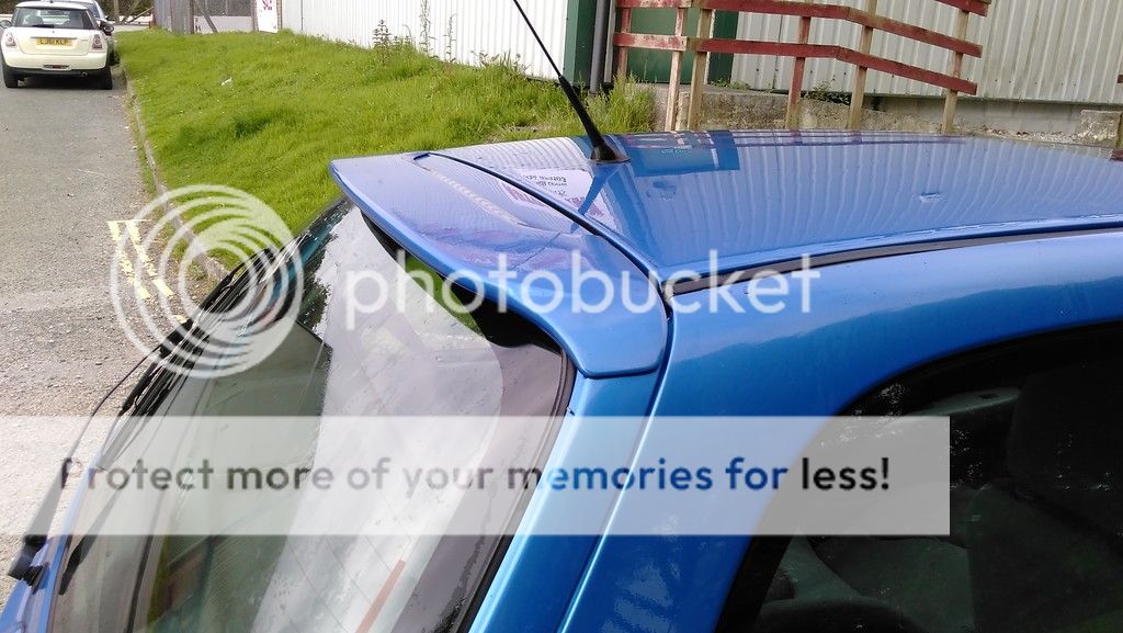

BlueSteel lives again. Mmm...spoiler?
How much & do they allow for the high level brake light? Thanks.
Hello Scotty.
£20 including the postage buddy.
I prefer these to the wrap around myself, I have a wrap on mine, but only because it came with the car.
PM me buddy if you want one, without checking, I think I have a blue one here.
Not the colour yours is, the same as in the picture, so easy match up for respraying.

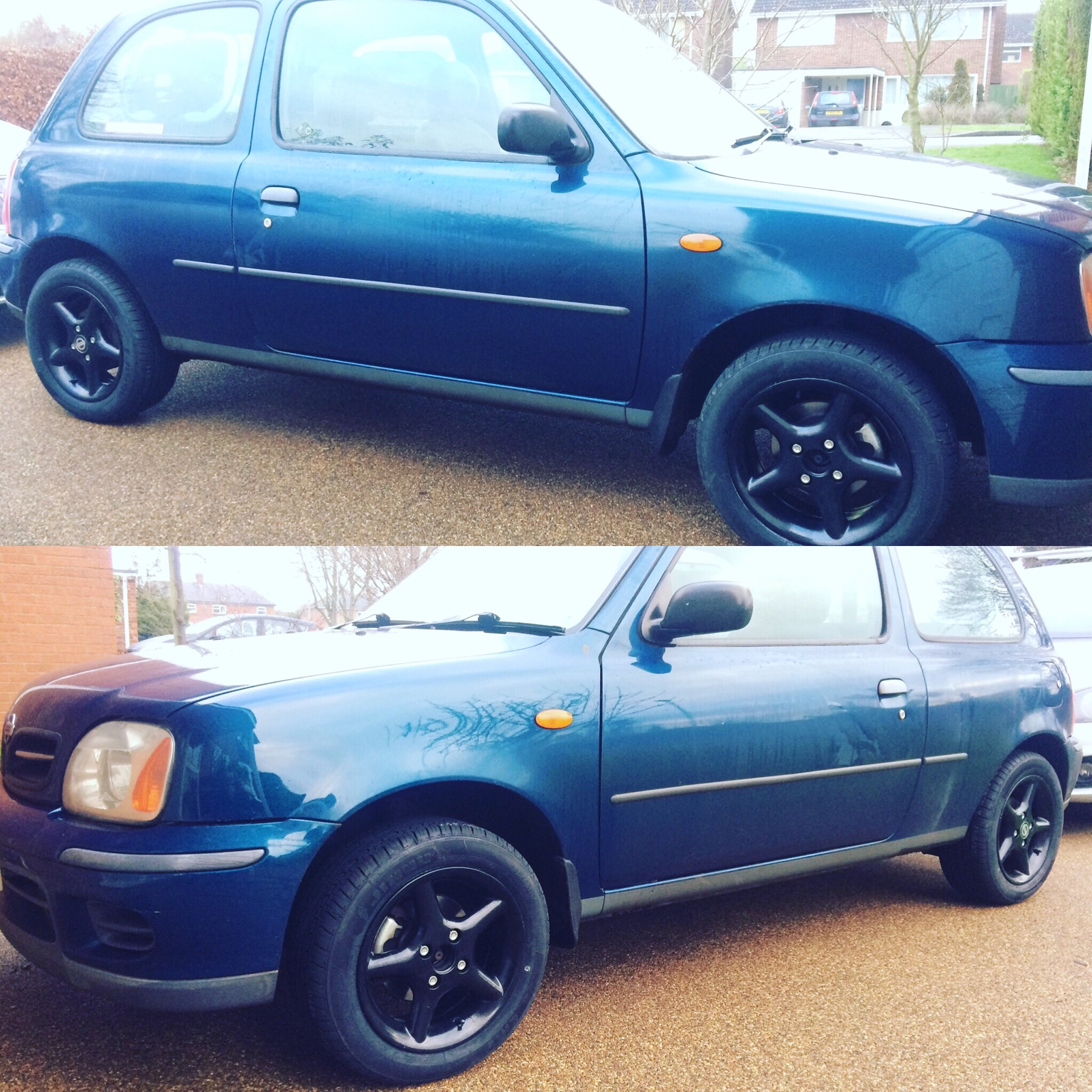

30mm drop lowering springs & new shocks have arrived. Time for some lows if I can find somewhere for my axle stands to go without going making holes in her!
