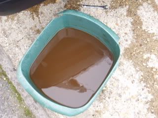

Mines a MA12 engine and i have no catch tank, just the rad with a cap on it
Its got hot lots to the point it has missfired and cut out
The rad was full of thick brown sludge, i suspect an oil gallery is seeping into the coolant. seems better now with clean rad and fan on constant lol
I just hope the head aint warped :down:
