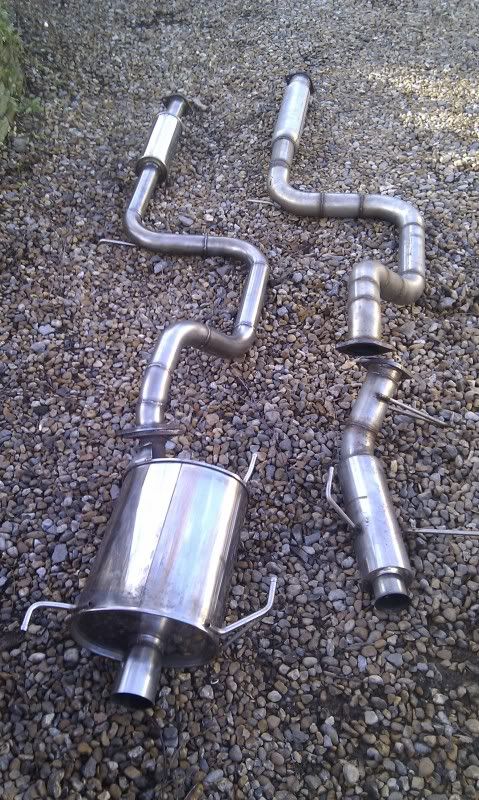

FH-5 i would do a 2inch midsection and just put your NISMO exhaust at the end of it to keep the velocity of the gasses up!
Ok thanks. I will do that - just a 2" mid section and put the 1.77" back box on if that will "keep the velocity of gasses up". Or I may match the diameter of 421 downpipe, I think it is around 2" anyway. Anyone elso feel free to add any advice :p.

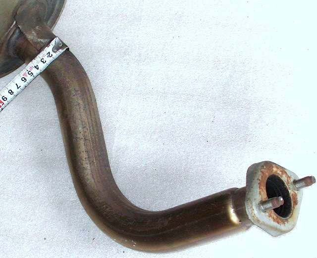

Mandrel of course, matching the manifold. But I don't know if my backbox is mandrel? Anyone know any cheap mandrel bent exhaust places in or around London (even Birmingham as I'm up there many times a month), just need mid pipe connecting from downpipe to backbox.
Thanks
The idea is that the bore gets slightly smaller towards the end....so your setup would be great. I did have a chance of looking at a Spoon exhaust on my friends integra. The bends are actually a bigger bore than the straight bits to keep the flow up but the backbox is slightly smaller bore tho ;)
If you look at the backbox photo the minimum diameter is at the flange, regardless it will still be fine. Most of the gains are seen in the manifold, until you start pushing things further you're not going to need anything radical, besides no-one on here pushes things anywhere near enough to warrant anything major.
Come spring time next year we'll see what a 2" system will support, so I will bookmark this thread for future reference along with one from back in 2007 when people were claiming that 150bhp could be achieved from an N/A CG13DE for £1500 ;)
The backbox pictured above is mandrel formed bends BUT if you look at the mounting flange you can see the pipe is necked down to a smaller diameter!

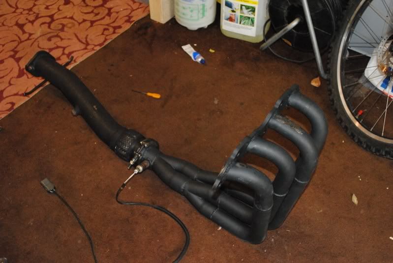

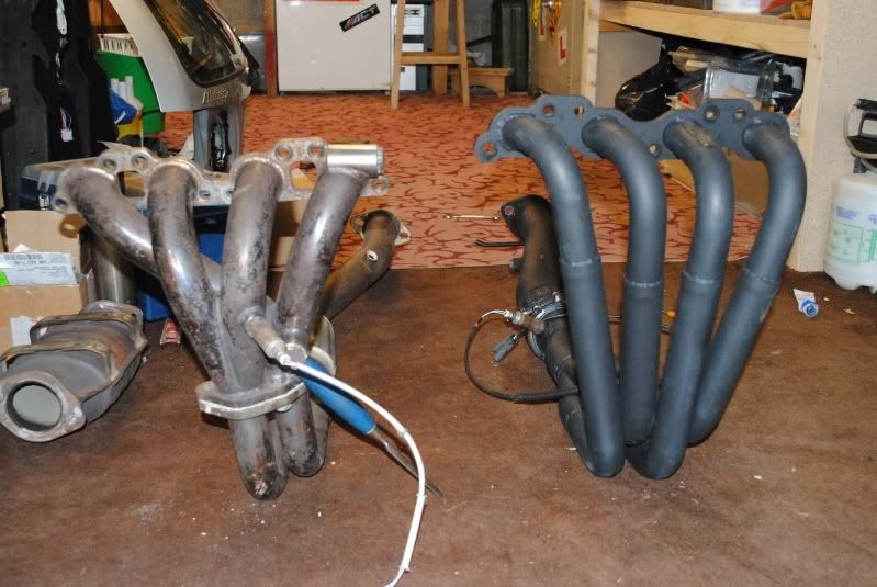

Ok, I measured the 421 manifold (pictured below) primary pipes on my K11 and it turns out they are smaller than 2" at 4cm which is 1.57 inches!
So should I still have a slightly larger bore mid section at 2 inches rather than sticking to size of manifold pipes which are 1.57 inches? In other workd, it would go like this:
Maniflod downpipe 1.57" - Centre pipe 2" - Back box 1.77"

Ok this is final, I am getting from manifold to back box 2" straight through pipe. Then back box will remain at 1.77". Case closed. Would I need a silencer or will sound be OK?
