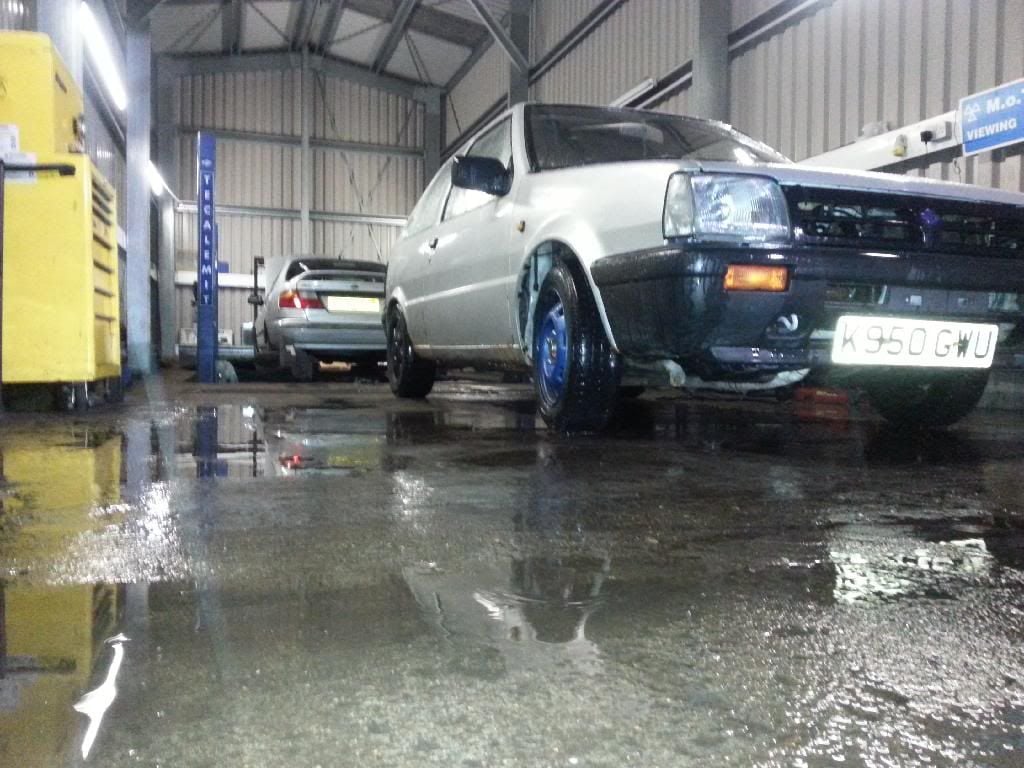

i was looking through auto trader and found this for £200 went and took a look looked alright so went for it
got it recovered to work today
best get started on this list :) will keep this updated

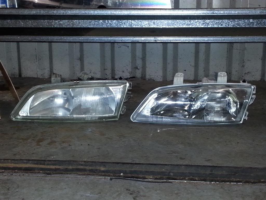

Headlight ordered from local motorfactors, should be here tomorrow new drivers sill panel ordered read abs with diagnostics came back as front right speed sensor open/short circuit​

new headlight fitted now,

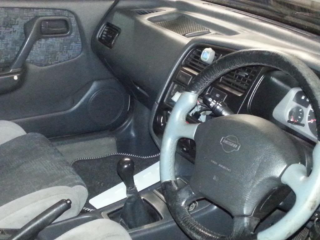

interior shot

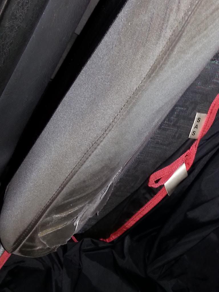

drivers seat could do with a repair might see if i can find a replacement

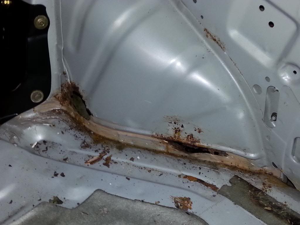

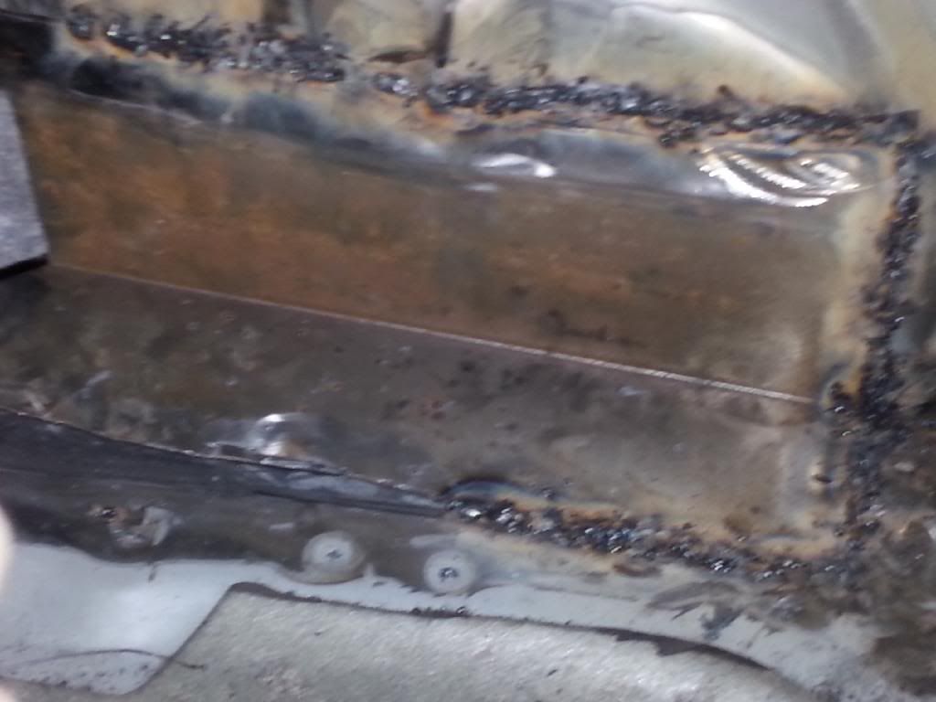

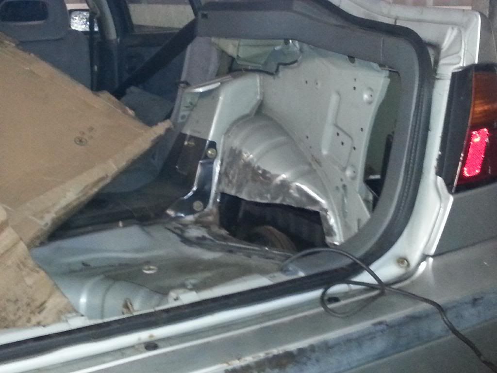

part of the mot failure
looked at it from the outside of the wheel arch and the bit in middle was rotten too so out it came,

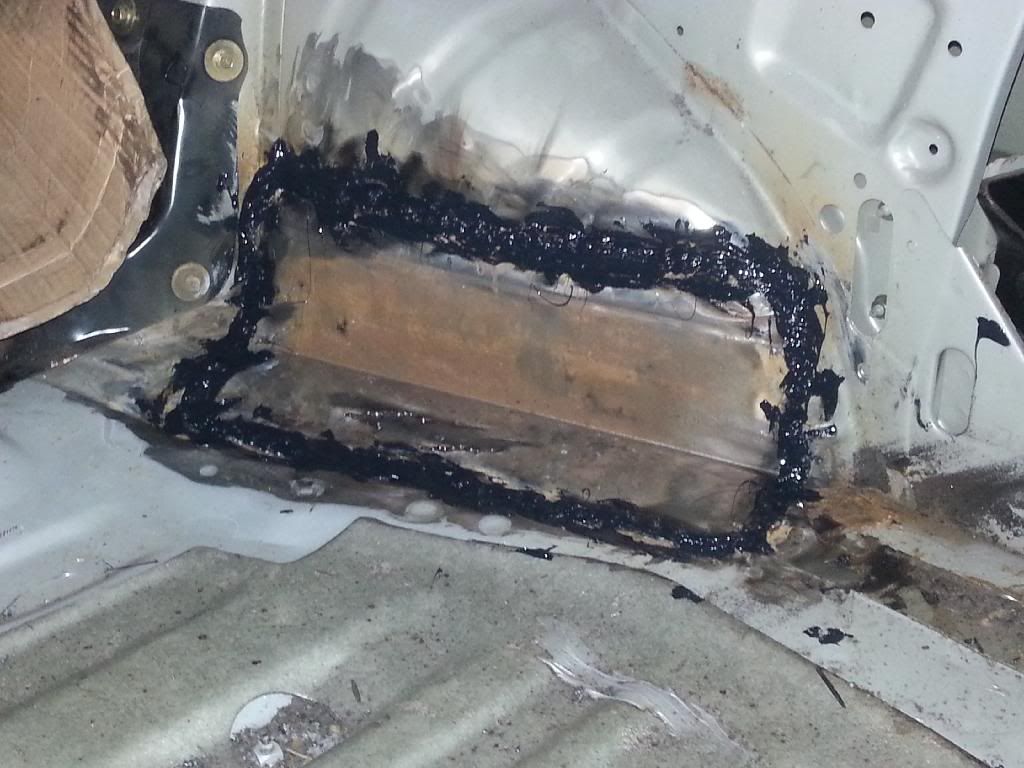

i attempted to weld it back in looks **** but it holds so not too bothered lol
bonus piccy

dude what you doing with the mera gti seats?
there going in my micra, but me dad bought another one for himself, ill ask him what hes doin with his in the morning
Nice man, I feel your pain with the rust, it's exactly where mine had gone although a lot worse than yours.
Check around the rear seat belt bolts, as there rotted on mine as well

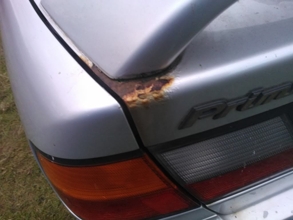

the inner sill, the sills themselves and the chassis legs would be another place to check as well. I am only showing you photos and giving you pointers as this is what has gone on mine.
BUT - a worthy upgrade to a Micra, once fixed, and you start doing bits to them, it will be a really good car :) and they look really good in silver too. I had a 1.0 k11 white 3dr before this :) Here is a photo of mine (and mine was originally an SRi, so same bumpers and interior as yours :) )
