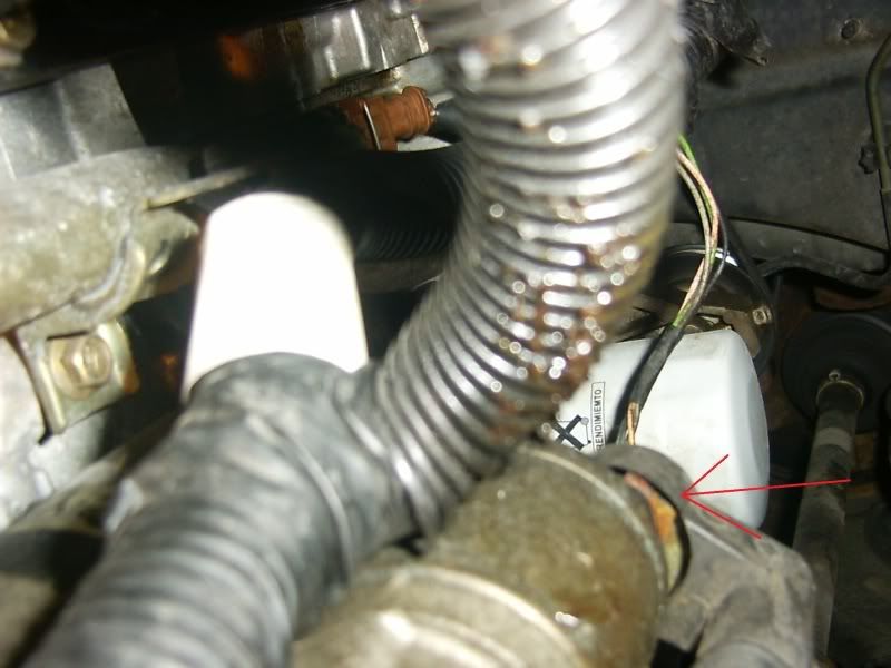

easy, take battery with you with leads.......jack up car from front then use axle stands if your not brave, attach via jump leads to thick red wire on starter motor as this goes direct to battery and the earth just attach any where on engine then use your key to gain entry....starter is located at rear of engine right side as you look at it from front.

I can locate what looks like the starter, but no large red cable - there's a black one which attaches to the frame and a smaller thinner one which attaches via block. Is the red shielded or covered in some way?

ok easy enough to get to its the wire with the rubber around it
hope this helps
