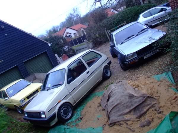

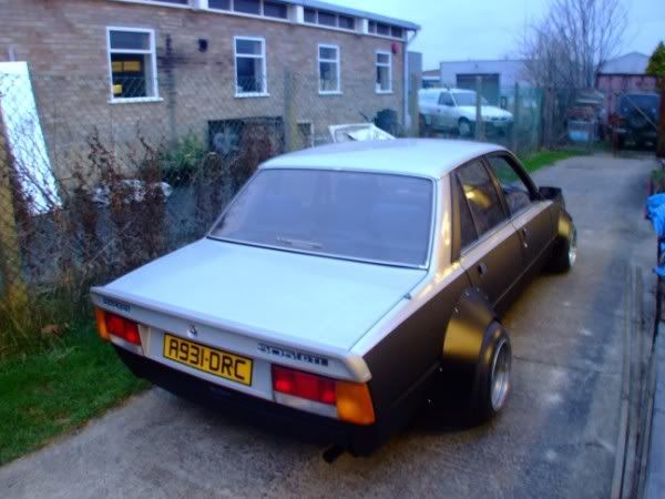

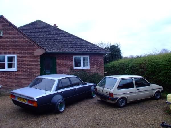

incase some of you have no idea what these are here is an example;
http://i29.photobucket.com/albums/c267/streetrules/DSC00042-1.jpg
http://i125.photobucket.com/albums/p60/LocoPolo/Polo/DSC04751.jpg
