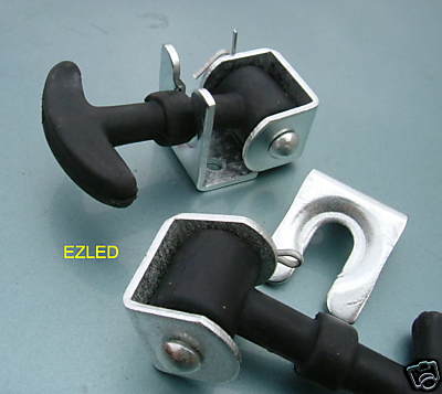

Mmm, how about something like this :)

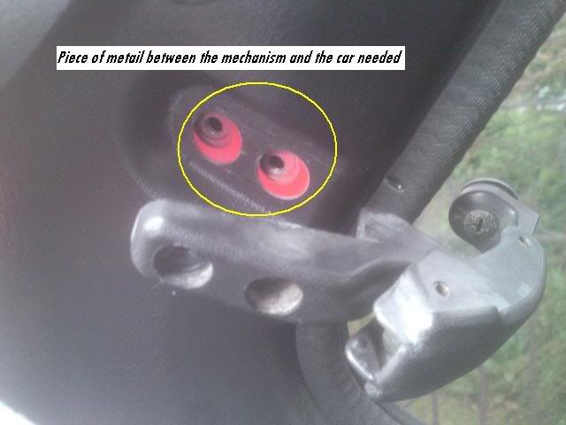

i think i sorted this problem on my old LS.
I inserted a small piece of metal approximately 1.5mm thick between the car body and the window mechanism on the inside (between the two screws like pictured) this then pulled the windows tighter into the car :D hope this helps (Y)
cheers
Steve
i have tried that what imp124 was sugesting....and while I have put screws back and tightened them....locking system has broke in two pieces.....right between screws hole :( ...I have glued it back and it is holding it for now (because...in Croatia there is not much of this cars...so spare parts is hard to find :( ...very hard to find...)....if someone has any advice on this window problem..I will apreciate it :) tnx
