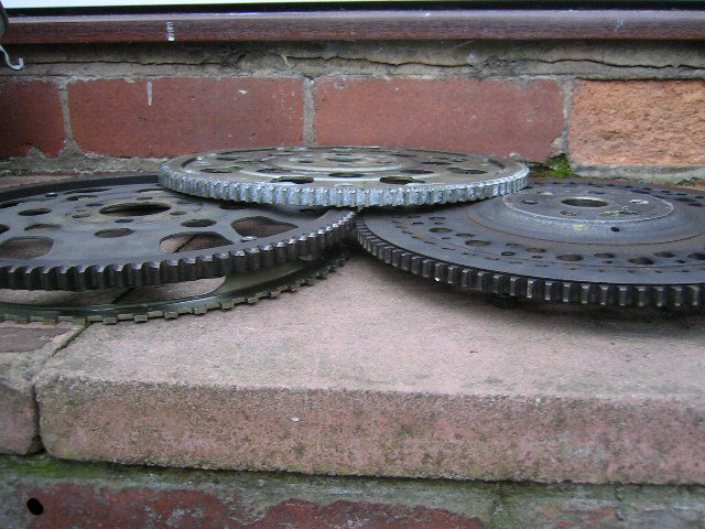

no, cvt micra has quite light flywheel with loads of holes in it. You could probably get pressure made up and welded onto it. I know frank has done that and I think he used some sort of disc brake to make the plate. You would probably ended up with incredibly light f/w
hope frank doesnt mind
pict0338-jpg.13907
