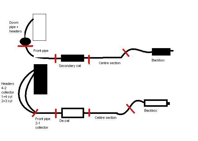

Maybe this pic will explain a few things:
I forgot to label the primary cat - it is the blob before the front pipe in the top picture.

naah its very good actualy, and with the 1.3 the increase over standard would be enough to make your car a whole lot faster, taking on (legaly) much faster cars than you first thaught.
you would go from about 80bhp to about 100bhp..... thats as much bhp as a 1.6 astra but with 1/2 the weight...
thanks craig :) does that mean that the second diagram you've drawn out would probably fail the MOT, obviously its no good if I cant get it through the old MOT :p
