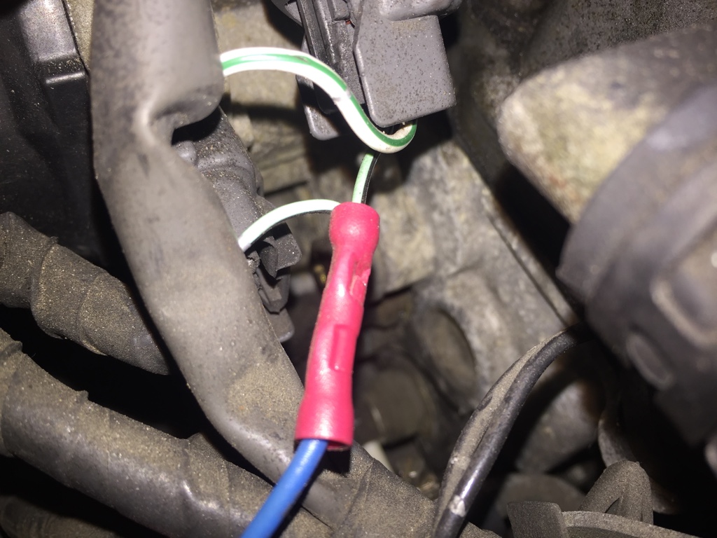

This didn't work for me, the wire didn't carry a signal as it wasn't connected to the ecu. Honestly it's so easy to just tap off the dizzy. Takes less than 5 minutes.

Honestly I just used a red thru crimp and twisted 2 of the cables round each other and it's been good for thousands of miles. Speaker wire will be fine I'm an electrician by trade and mines just some blue core pulled out of a length of twin and earth! No current or anything going through it merely just a signal. If you want I can take a photo of the exact cable I tapped into tomorrow.

That's what colour it is on my car, easy way to tell is it's the bottom cable of the plug that goes into the dizzy.
