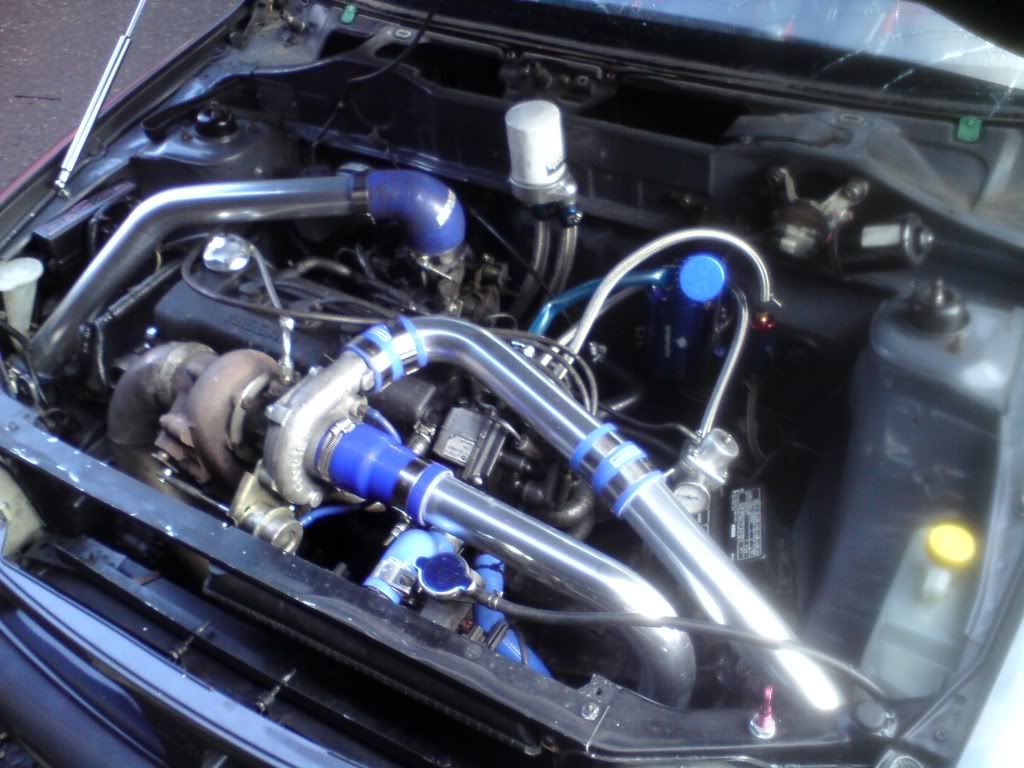

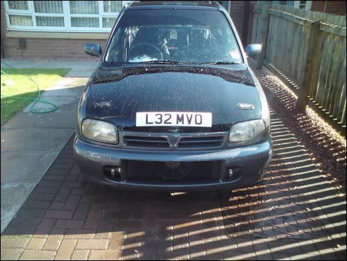

Look at this picture bottom right you can see where i fitted mines and yes i done them, whats your purpose? My intercooler was that big i had to do away with the bonnet catch completely
For styling and to try and get my bonnet to sit level as. It sits high on one side wouldn't mind turboing it or putting a bigger engine in but can't yet due to insurance :-(
