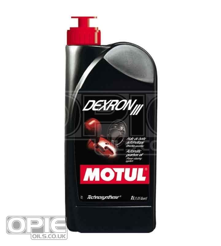

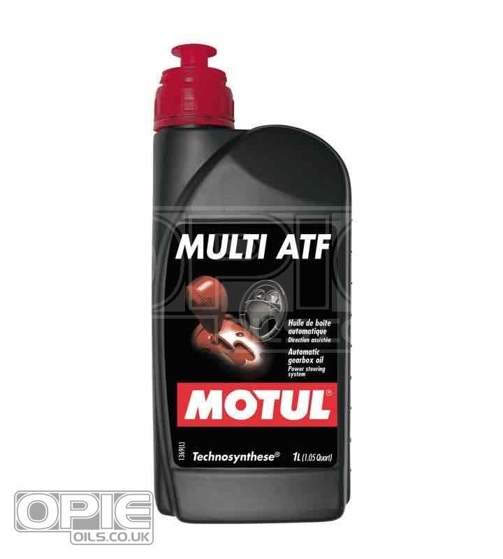

Automatic Gear Oil:
its also time to change the gearbox oil. i will like to know which ATF do you people use. should i use Multi ATF or Dexron III ATF? thanks.

For the transmission, the ESM states 'Genuine Nissan ATF fluid' or 'Dexron III'. The plugs it recommends are NGK LFR5AP-11 or Champion REC10PYC4 - both platinum tipped. Correct oil viscosity id 5w/30, I'd go for any decent brand of fully synth :).
Thanks for advice. how much gear oil will i need? the ESM says 7.7 litre with torque converter.. i didn't find how much gear oil will i need when changing it cuz im not changing the whole thing, just the oil.
