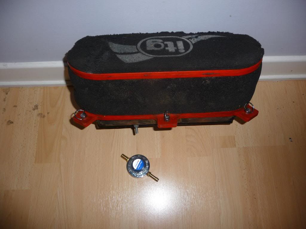

Ahh awesome. I got two new toys now :p. Got a fuel regulator from a mate so I can set the PSI to about 3 so they dont keep flooding and the carbs came with this original ZZR600 airbox which had been modded to take ITG filters. I need a smaller filter though.

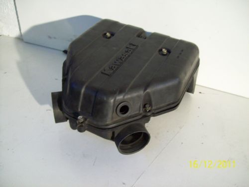

I was thinking of using an orignal ZZR600 airbox with a K/N filter in as you can get two huge pipes on them, have those pipes go to the front grile and have a ram air system. Colder air which should mean more power?

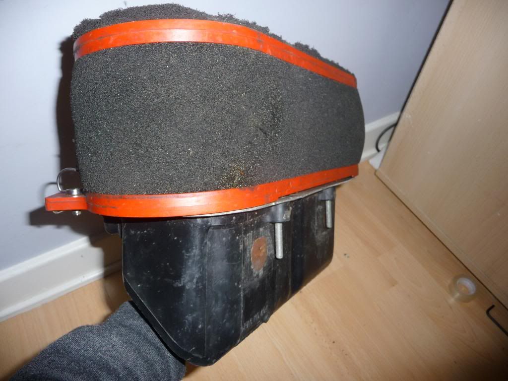

Right then I got a spare rocker cover so going to mod that so I can fix the bike carb airbox in.
The oil breather pipe with the blue circle around it will be cut off then plugged with a grommet sealed with gasket sealer. Either that or weld some sort of plug to it.
The two orignal airbox mounting points will be used to mount the new airbox. I will have to make spacers for it to keep the plastic airbox from touching the rocker. I was told though that the plastic has a very high melting point. Also going to put heat proving underneath the airbox.
The other oil breather pipe will have a oil catch can attached to it and the other pipe on the catch can will be taken underneath the car. I was told if you run the pipe underneath the car it creates a vacuum which helps suck the oil out which keeps the rocker/engine cleaner.
Here is a picture of the airbox again. It will have a nive K&N filter fitted and two big tubes going to the front grille to suck in loads of nice cold air. At the moment I got a great big airfilter at the back/top of my bay which sucks in alot of hot air.
