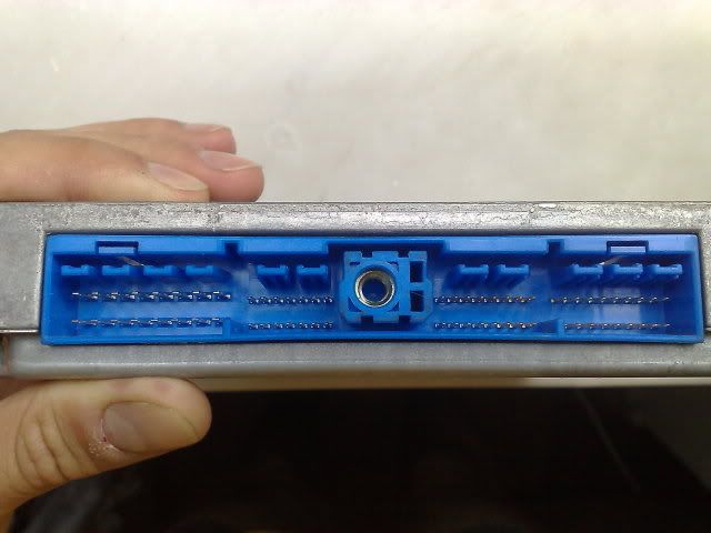

Hi, i own a '99 Micra and i was looking for reprogramming its ECU.

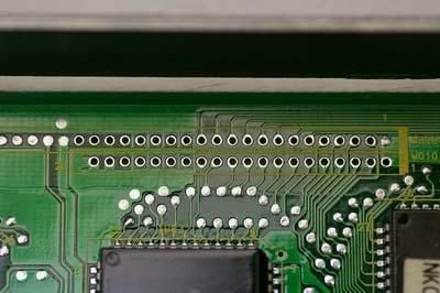

Older K11 ECU's have this connector type:
And inside:
It has a 20pin + 20pin connector to solder the daughterboard.

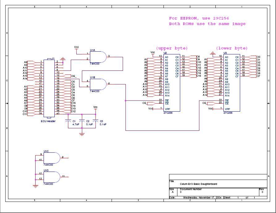

Older K11 ECU could use Calumsult board, i think its the same as B13:

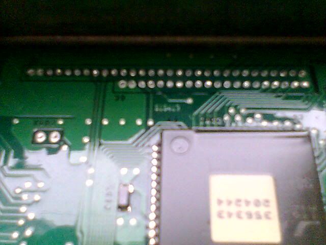

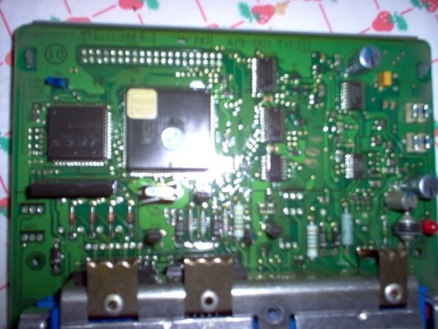

So, the daughterboard used on older K11 ECU doesnt work on my ECU because
my ECU has the same external connector but inside its different (30pin + 20pin):

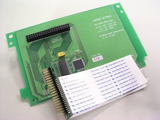

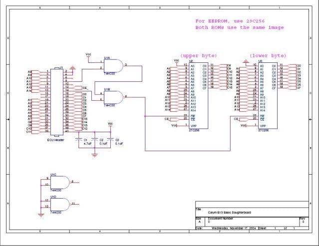

Its very similar to what N15/S14a NIStune Type4 Board uses:
Can anyone confirm that NIStune Type4 Board will work on my ECU?
Thanks
