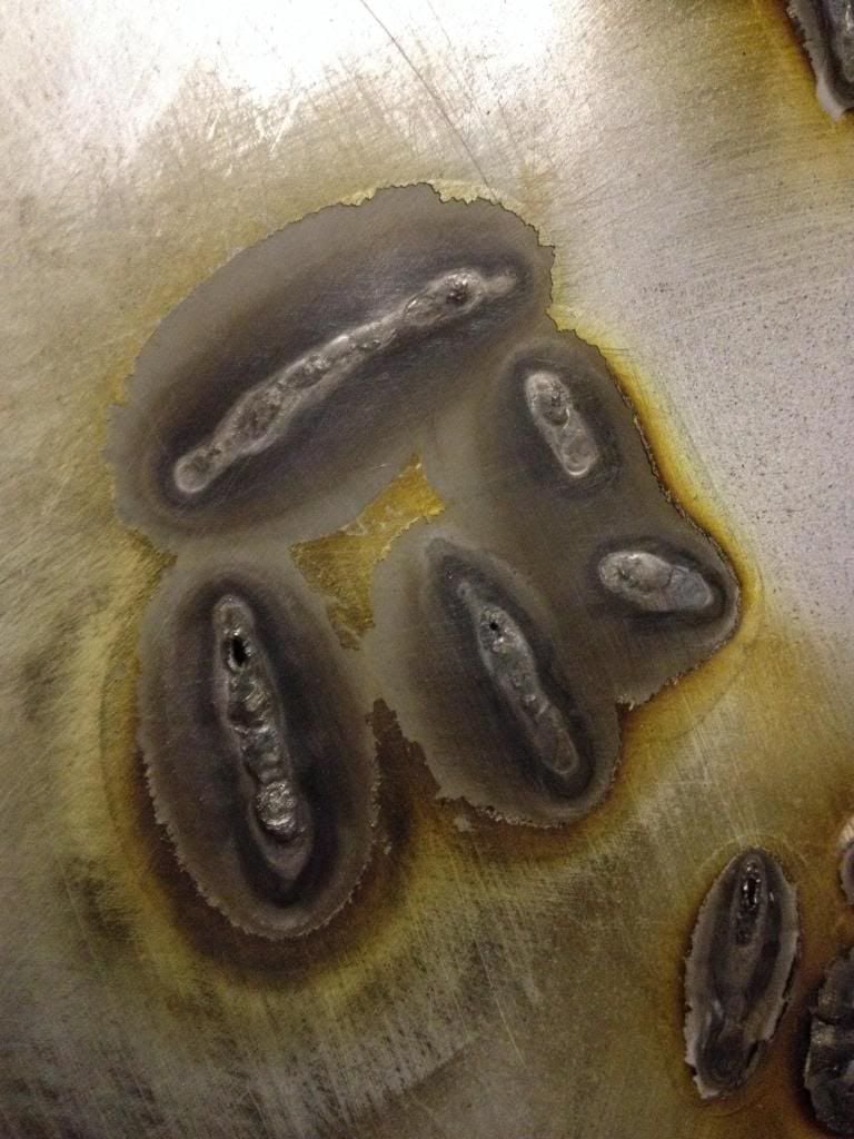

Welder arrived on friday, went straight up to the garage and started practise on a bit of sheet metal. Heres a pic of the penetration with C02 only
That i was quite happy with although on the other side they were quite thick/tall welds. I also done some overlap welding and that went well too but why when i take it to the car it doesnt go as well? Lol and no i havent attempted the engine mounts, i plated one of the rear arches from where the cage was removed.
Advice, hints, tips welcomed :)
9/10 times I have a bad run of welds ita because I've chosen a bad earthing point. On a car its especially tricky. Me and Chris found that taking the steering wheel off and clamping the earth to the column wasn't too bad of that helps.
Cleanliness of the metal is key when welding on the car.
If you have a good clean earth point you'll weld much better :)
I find using the steel twist knot brushes is best to get the metal clean :)
CO2 is perfectly fine for steel but Argon (25%)/CO2 (75%) I've found is better for the thinner stuff 1mm or less
Wire thickness is another factor. Thinner wire for thinner work pieces.. up the wire thickness for thicker pieces.

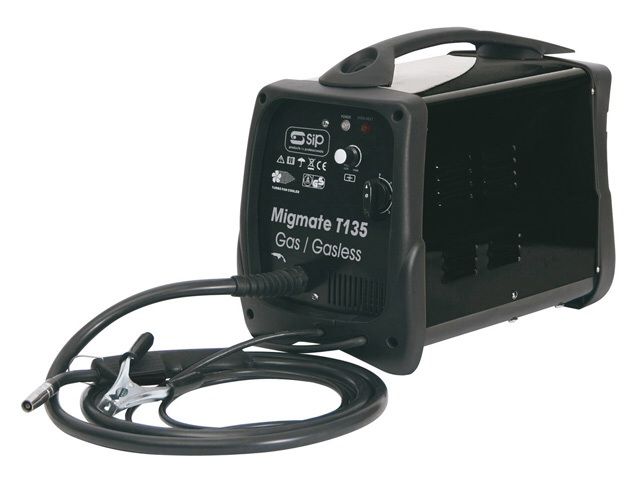

My welder is only 135a but with 1.0mm wire on max amps it can cause havoc with 10mm steel. 0.6mm min amps it'll weld 0.6mm steel all day long
Hope that helps Stani :)

Maybe its to do with the way different welders convert the AC to DC. But pitting is caused by contamination, wether its oil on the metal burning off and the gases escaping through the molten metal or hydrogen contamination (hydrogen disolves in molten steel and escapes as the metal cools, one of the many reasons you need a gas shield)
