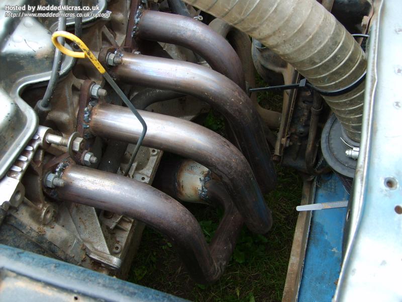

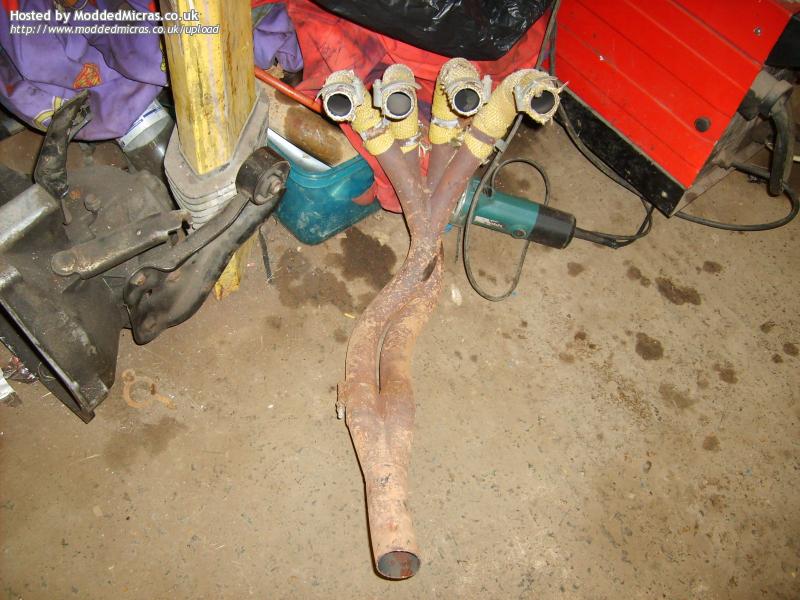

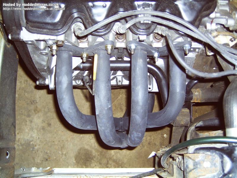

..no for the road you wont a 4 into 2 into 1 thats 1-4 and 2-3 together like this one
