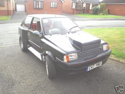

Nice work! Probably the most extreme and well thought through K10 modification I have ever seen to date. I think this may be the kind of mod that all others will be compared to! Not sure what I think of the spray paint that must have been a pain to do the car lol! Good luck with the MOT, and please keep us upto date.

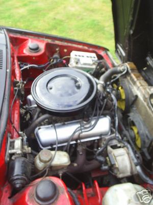

It's tuned up ok at the moment. I had problems with the carb as it was chucking fuel down one side instead of an even distribution causing menacing backfiring. Turned out to be the two butterfly valves not being synchronised. Runs sweetly now. Revs pretty freely. Engines had a slight overbore to 3.1L, the rest is pretty standard.
Paint's been polished up since the pics and the bumpers modified for lower and meaner angular look. Still a dirty black. Cheers everyone!:laugh:

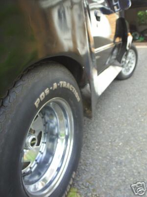

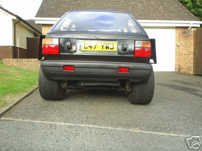

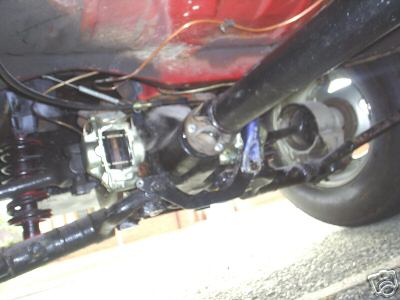

Its great, Something I have always wanted to do but never had the time. I would probably have gone for a 200sx running gear or tried a mid engine setup. One thing for sure that car is going to be VERY tail happy, there is no weight in the back of that at all!!
That was my prime concern when building it. I have made it pretty weighty at the back though, the jaguar axle weighs in at 80kg and I made a new fuel tank from 2mm guage steel and positioned it behind the rear axle for added balance (and safety from rear impacts). The rear arch extensions are all steel fabrications too as well as the side skirts which are structural (to stop the chassis twisting under load).

I knew nobody out there would have tried to do it properly because of converting it to RWD. There were no real aims, it's just sort of......grown! Yes if I had alot of money I would have done it PROPERLY with lots of aluminium. But aluminium is so difficult to work with and is subject to fatigue really easily. The wings are difficult to see in the pictures but there are intakes and exits above the bumpers. The front wings too. I will probably need a wing of some kind for corners, but this only has to go striaght for 1/4 of a mile. :upside:

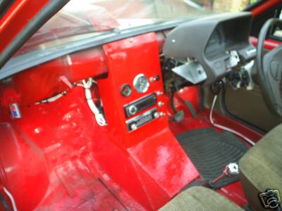

All steel centre console finished with tachometer, chrome clocks, vintage radio for the standard micra speaker (in the passenger footwell, LW & MW only!) and more modern Sony CD player. Replaced the quarter panels in the back for 1/2" MDF for my Pioneer 6x9's and covered with origional panels for that nostalgic look. Tidied up the arches where the fat wheels were catching and donned the petrol tank to the brim with Sainsbury's UL petrol and Leaded suppliment from HalFrauds.
Treated the Jaguar differential to a new home-made gasket and oil.

Spent ages setting it up, tuning the twin carb with timing light and dizzy dwell angle 'till the engine roared. Whizzed it off to the MOT man, had great fun testing the turn of speed, left the keys and went back. 10 minutes later they asked :" Come over, we can't get it started again". They had driven it in fine and had it getting warm for the emissions test (which is a joke for a 1977 3.1L running Leaded petrol). But it just stopped. Got there, tried the usual trick of pouring a bit of petrol straight down the carb, but to no avail. Had to end it there.
The guy was willing to test it though and had already pointed out a few minor concerns...
The hand brake had too much travel.
The battery didn't have a tray and was loose.
The steering was too heavy.
:suspect:problem seems to be predominantly choke phasing, causing the engine to flood at high revvs (like the prolonged period during emissions testing at 2-3000rpm, especially when the engine is cold). So I stripped the carb and found a 20-odd year old diaphragm for the choke vacuum pull down with several small perferations from the abuse the garage mechanic gave it. !"£$!^"%£! grr
So now I need to get hold of a Weber DGAS 38 carb gasket kit, not as easy as it sounds without waiting a week. o_O

The clearence that the wheels give are probably necessary to ensure that the rear transfer box doesn't hit the floor!! Doubt it would be possible to get even majorly feathered throttle down on stock wheels....you'd be pulling off in fourth! lol
