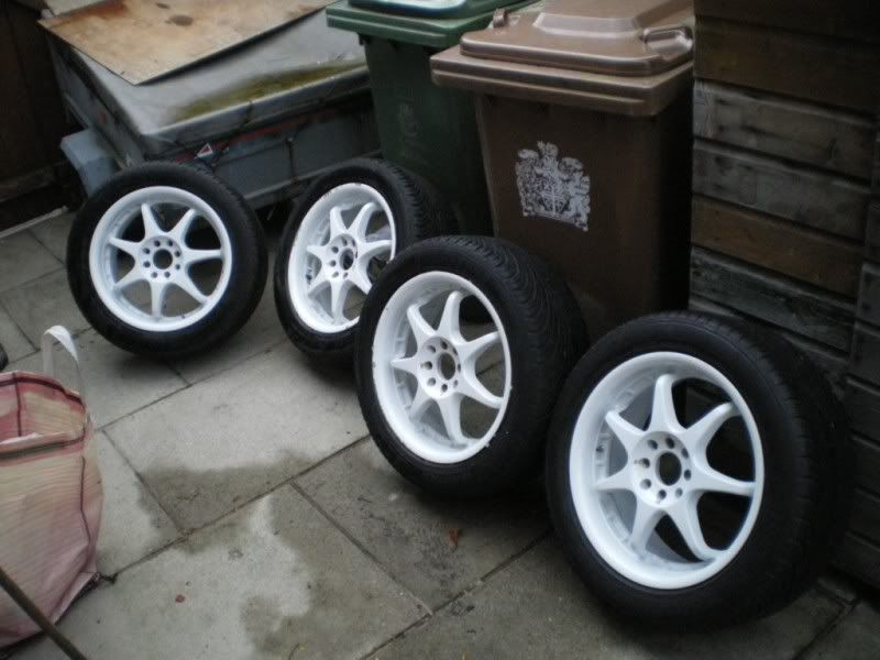

Hi guys, i bought the wheels below off ebay but ive found that when i offer them up to the hub the studs are too short, i know i need some slimline nuts and spigot rings but im wondering how hard it is to remove studs as ive found a website that sells the studs.
any advice ?
The studs just knock out the back of the hub, Put a nut on to protect the thread if you want to go back to standard and hit it with a hammer. The new ones slide right in. Nice wheels btw
sweet, i think it would be like that but wanted to check with someone, gunna cost me £70 for the studs :(
thanks, they are Enkie wheels! got them nice n cheap with 1 month old tyres on
