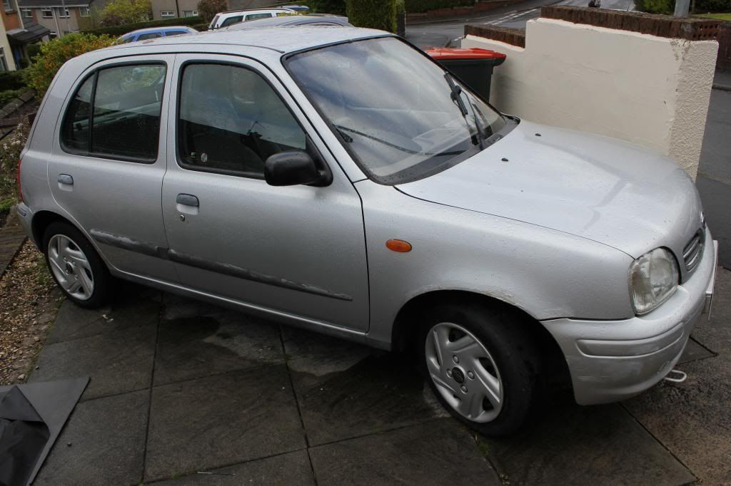

My car: given to me by a family member as an early 18th its a 2000 silver nissan micra 1.3 5 door. Battered exterior with some dodgy work done to it, (pics to follow).
Stone chips to bonnet look like bullet holes and extremely thin wheel arches.; High priorities.
The plastic bumbers and side panels are stained with wax they look bleached. All in all a dodgy looking ride.:(

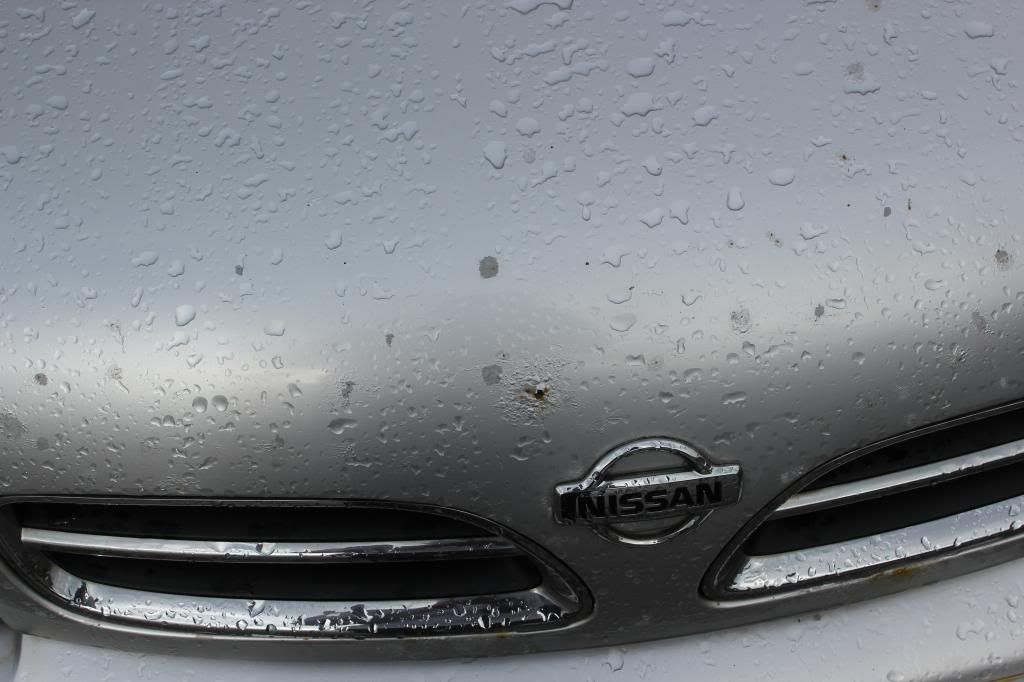

As you can see the bonnets got some major stone chips, they dont look AS bad because the cars wet but you get the picture.

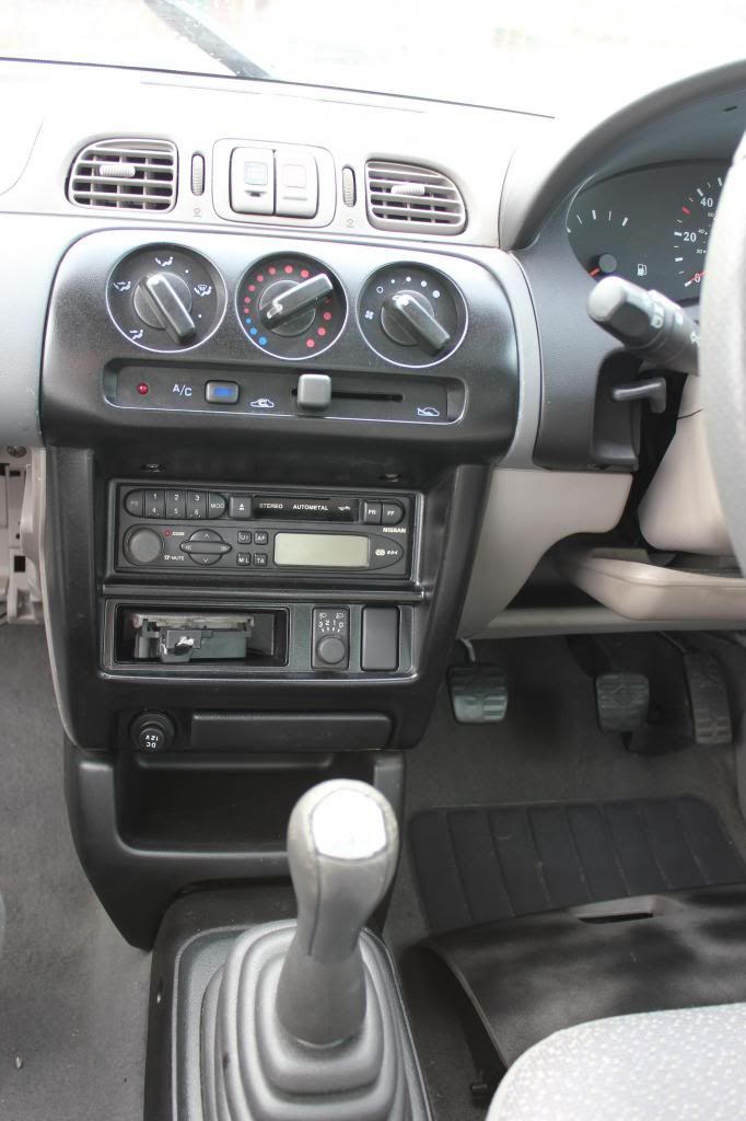

My first change was to remove the centre console, speedometer guard and spray black, this cost me £5 but I think it makes it lok 100% better. im on the first coat of black on the glovebox too.

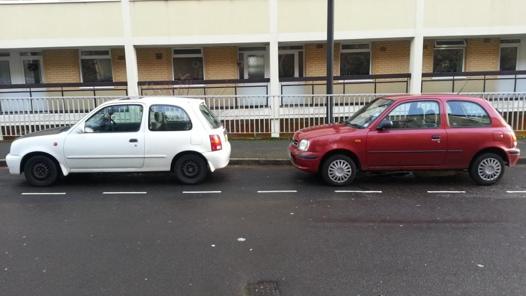

That's 35mm lower on left, standard on right. You want 50mm really min for noticable arch gap loss, so don't bother with 35mm lowering springs unless you plan to chop the rears later as part of a corsa coilover based drop or similar later, will just be wasting your money in the long run otherwise...
Yeah was researching 50mm earlier. Definately!

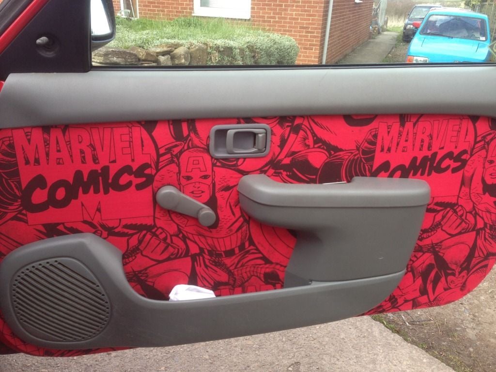

When the fabric was wrapped on the door cards in:
http://micra.org.uk/threads/red-celebration-revamp.56202/#post-593322
..The previous door card fabric was left on there, and strong glue was used to stick the fabric to the door card - glue is the white glue stuff as seen in the pic:
..It was applied to the front and back of the door cards and the fabric was stapled in place on the back of the door cards, which is hidden by the top grey plastic bit as seen in:
You could always staple wherever plastic covers the fabric to hopefully prevent it from sagging down over time i suppose as the staples would be hidden by the plastics and fittings.
Hope this helps! -There's more details in the original thread i linked, should you need it, or to ask any questions about the process http://micra.org.uk/threads/red-celebration-revamp.56202
