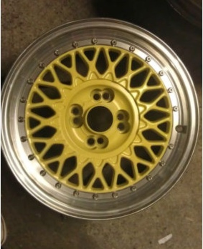

Can vouch that Rotas are pretty awesome. I see a lot of hate, people saying that they're not well made, blah blah blah. I go to a lot of grassroots drift events and everyone there uses Rotas no problem. Even big named companies like Driftworks rock Rota wheels on their pro-spec drift cars.
Not to mention they look absolutely quality and they're a quarter of the price of the originals. No stupid JDM TYTE tax.

May have just bought some Lenso bsx's. 15", 7j, et 20. So will need spacers. Also need some work, centres, and tyres -_-. £250 feel a little ripped off if I'm honest but whatever.
