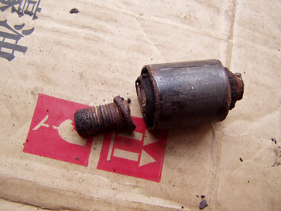

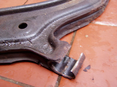

maybe try seperating the arm from the bushing like this to get better access with the grinder
c725uz-129-jpg.31368
then carefully cut through the bolt between both sides of the inner bush collar and the chassis with a thin cutting disc

the best way to remove the bushes is to heat the wishbone (i used a hot air gun), and use an appropriate size socket to knock the bush through.

been down your road a few months back, was also amazed at the ratchet springing back when trying to loosed the bolts.. what happened was that the rubber bushes simply fused to the bolt and the wishbone shaft. Grinding everything out was the only feasible solution. In my case the wishbones didnt need much replacement, other parts were to blame for knocking I was getting ..but that's not the case for you.
