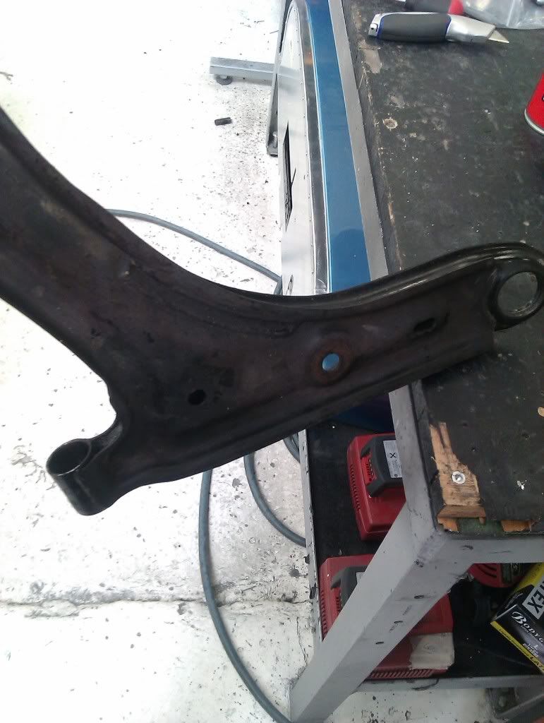

i drifted my k11 balljoint downwards mate (i,ll take a pic later) and one of the rally guy,s on here has snapped a couple of copy wishbones recently iirc (i think i would weld some tube all around the edge personally)
pic :)

I've taken a few rough measurements & settled on removing the old Ball-joints from my K10 arms. I hope to replace them with K11 ones.
I have stitch welded the K10 arms & drilled them to accept a K11 anti-roll bar.
I have cut out the K10 ball joints & am going to have a shot at smushing in some K11 ones this evening.
Just as a side note, ball-joints are not to be removed with heat!
I hoped that heating the lca around the balljoint would free it up a bit but instead the bugger exploded.
Hi-ya whipit,
I did think about using camber bolts but ruled it out because even if I could correct the camber, I would be left with a 2" reduction in track width. Seemed counter productive.
In the end I finished up with K10 arms, had to cut the old balljoints out & polish away their retaining lip using one of these.
Then pressed in K11 balljoints.
While I was at it I stitch welded all the way round the lower arms & drilled them for a K11 anti-roll bar.
