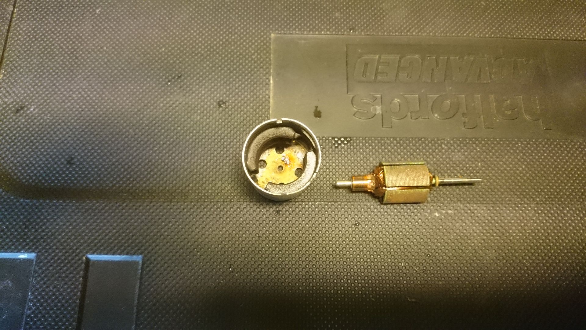

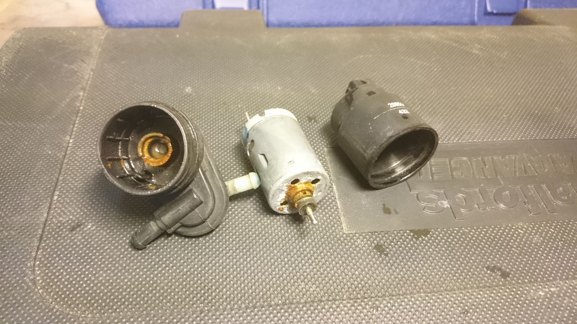

after removing the pump I found this -
to be fair even after a total clean up and drying out I could fully understand the issue. sometimes when the pump was plugged in wiper didn't go, sometimes they did. but anyway fingers crossed a new pump sorts it

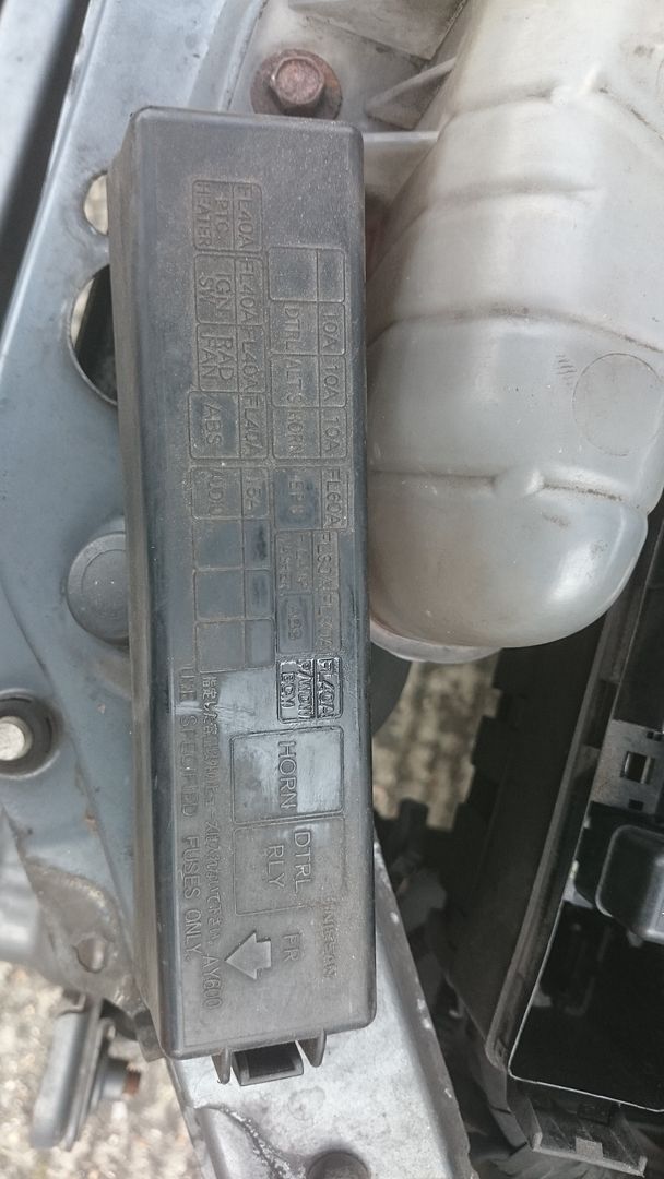

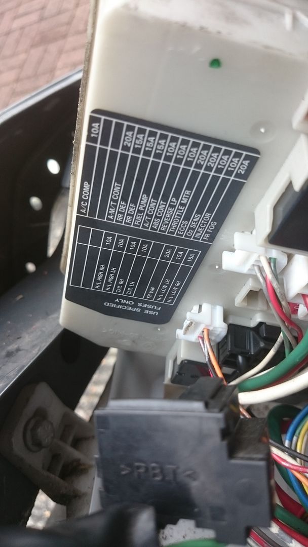

is there a dedicated fuse for the washer pump?
the only one of relevance I can see is on the black fuse box in the bonnet
cant see one here
