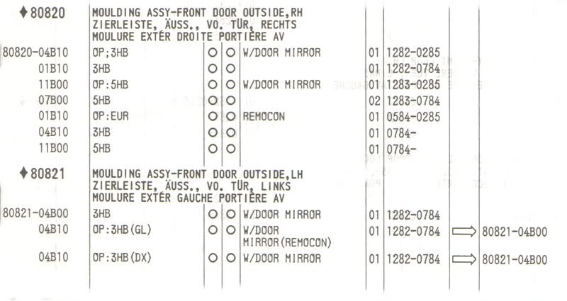

Heyas, I am getting my rust cut out today and am going to try and get some original window seals. Mine are rusted through and the one on the drivers side has spread into the door a little, so i'm not too keen on putting the rusted seal back on there after getting it cleaned up. I've tried to find the info myself but just wanted to double check that this diagram I have is for a two door k10 and the parts i need to try and get from nissan would be 80820 and 80821. If anyone knows someone over in the UK that would have some in good knick they could ship to Aussie land let me know.

So is that diagram the 2 door? And would those codes be the actual part numbers??

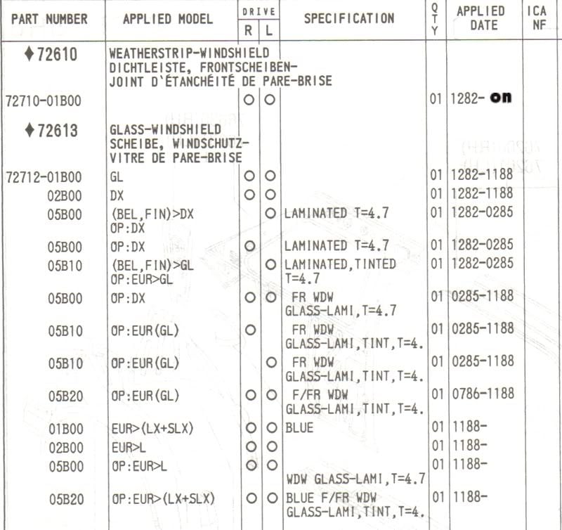

One more thing. I'm getting rust taken out around the bottom of the drivers side of the windscreen. And for now we are just gonna chip it out as best we can and then treat. The reason being that we cant source a windscreen any time soon. The supplier says he can get a k10 windscreen soon but it is different dimensions on the super turbo. Does this sound right to you guys??

Thats the part nos. yes,going by the picture put the the no in the top left before the window seal part nos.
I'd say you been bs'd there about the windscreen dimensions
Unless he knows more than what's below then it isn't :)
Those numbers correspond to a Parts search code used by the Dealer.
Part numbers below NB:Nissan charge £50.07 each
