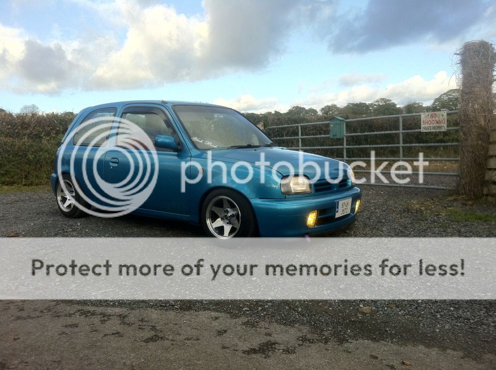

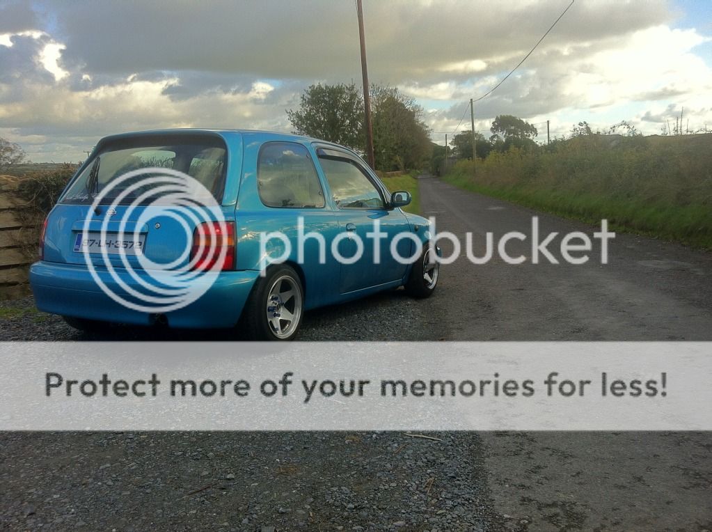

hi guys,
going to get matiz front struts on saturday and do the perch drop, also going to get corsa b rear shocks with cut spring rear set up. Just want to know i have et6 13x7 starmags with 165/65/13 tyres all round and i just want to know do yous think it will rub ? anyone got pictures of cars with perch drop and how low they are? i have an adjustable panhard for the rear so i can bring the wheels in , let me know what yous think! :) heres a pic atm with 2 1/2 coils off rear and 3 1/2 off front
Will probably rub! This is mine on the matiz perch drop and it rubs sometimes
On 14's with 165/60 14 tyres

yeah im running cut springs but i keep busting rear shocks and the front is very bouncy, plus with the new set up it will pass nct and handle better, got the set up today rear shocks were new ones from corsa b , delighted!

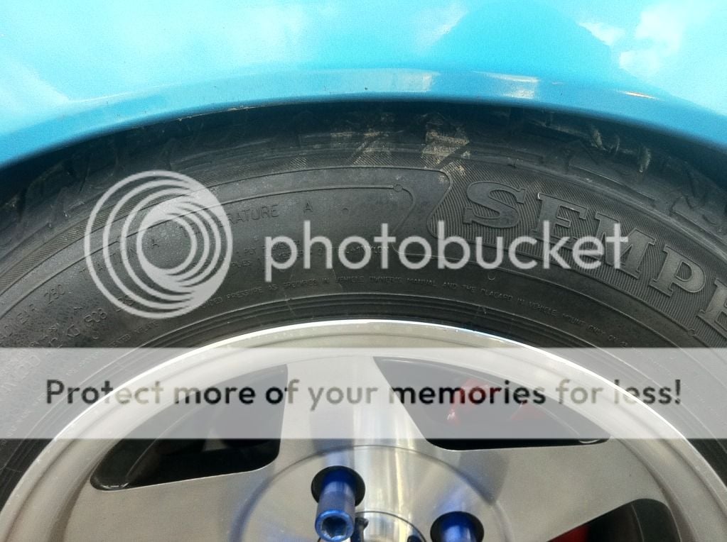

well i got it all together after a while cut another half coil off rear with corsa shocks, now my problem is the front is way to low and wheels rub and causes rubber burr on arch, do i need to use matiz top mounts or micra? at the moment im using micra spring top hat and micra top mount, is this causing the problem of it being too low?
yes micra topmount finto, you might have to raise the perch a bit, i used some left over corsa big-end shells to raise mine, you.re best not to weld directly to the shock tube ideally (ie, weld the perch to the collar/shells, and weld the collar to the hubmount/bracket)

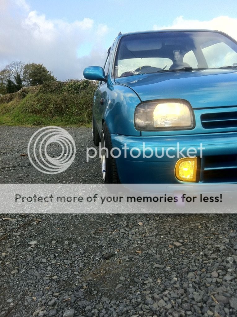

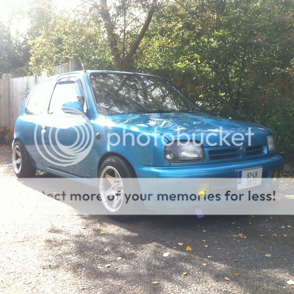

the car sits the width of an iphone on the front with splitter on, how much would you say i need to raise it? as i welded the perch a finger width off the hub mount bracket? pictures to come waiting for photobucket to load
you cant slide your iphone under the splitter ? :eek: you,ll need to raise it more than a finger width then i guess :)
filled the upper hole and pushed the hub in and i now have enough clearance to run the front starmags :D had to higher as couldnt carry any passengers, will be sorting that out with smaller tyres for the summer as ive a set of winter wheels to go on for nct and winter.. pics to follow tommorow :)
