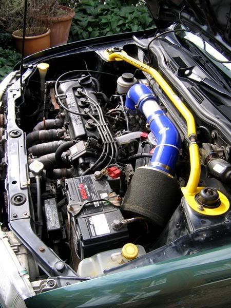

You could do an olly special (tho other people have done the same)
What you do is buy a 90 degree aluminium intercooler pipe, ram it on the TB and stick a cone filter on the end.
I'll have pics up at some point.
the whole thing cost under £15, there's a few members use/have used drainpipe, I'd change it for an aluminium pipe and Samco bends, but I'm so tight that I make a ducks A-hole look porous.

but anyway ive seen inductions like Retepetsir avatar and they look nice but what do they sound like and performance and how much we talking?
so are people telling me that what ive got at the moment is the best way to do it but i need to get a better cool air feed? est way to go about cool air feed?
hmm. i might have to try the drain pipe idea, looks good.
at the moment i just have a K&N cone bolted directly on top of the throttle body, sounds beasty !!

may sound "beasty" mate but you may missing out on some power......main cause heat. but then maybe not!!
ive tryed all sorts of different positions (hey, stop the rude thoughts right now :grinning: lol) for my induction kit!
the drain pipe was good!!! but ive changed it back now!
Edit: The previous owner (Dan - MicraCharge) tuned this intake setup for the best power and torque gains. It takes advantage of the 2nd and 4th harmonic to increase torque lower down in the rev range (it peaks between 2000 and 3000rpm, as proven on a dyno run).
Putting a filter straight on top of the TB is pointless, and this setup gave the best gains.
Hope that helps!
