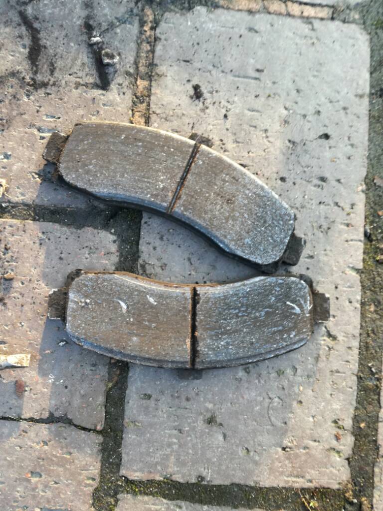

Helle every one. Can some one help me with please? When to change brake pads? These are my current pads.
Sent from my HUAWEI VNS-L31 using Micra Sports Club mobile app
Going by the wear pattern on the pads your discs are just about worn out. When you do change them (I never let pads go below about 4mm friction material thickness) this time you really need to fit new discs at the same time as well.

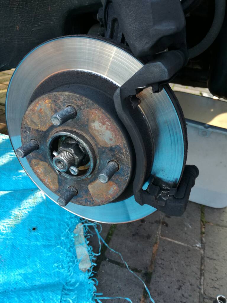

Here is the current state of my disks

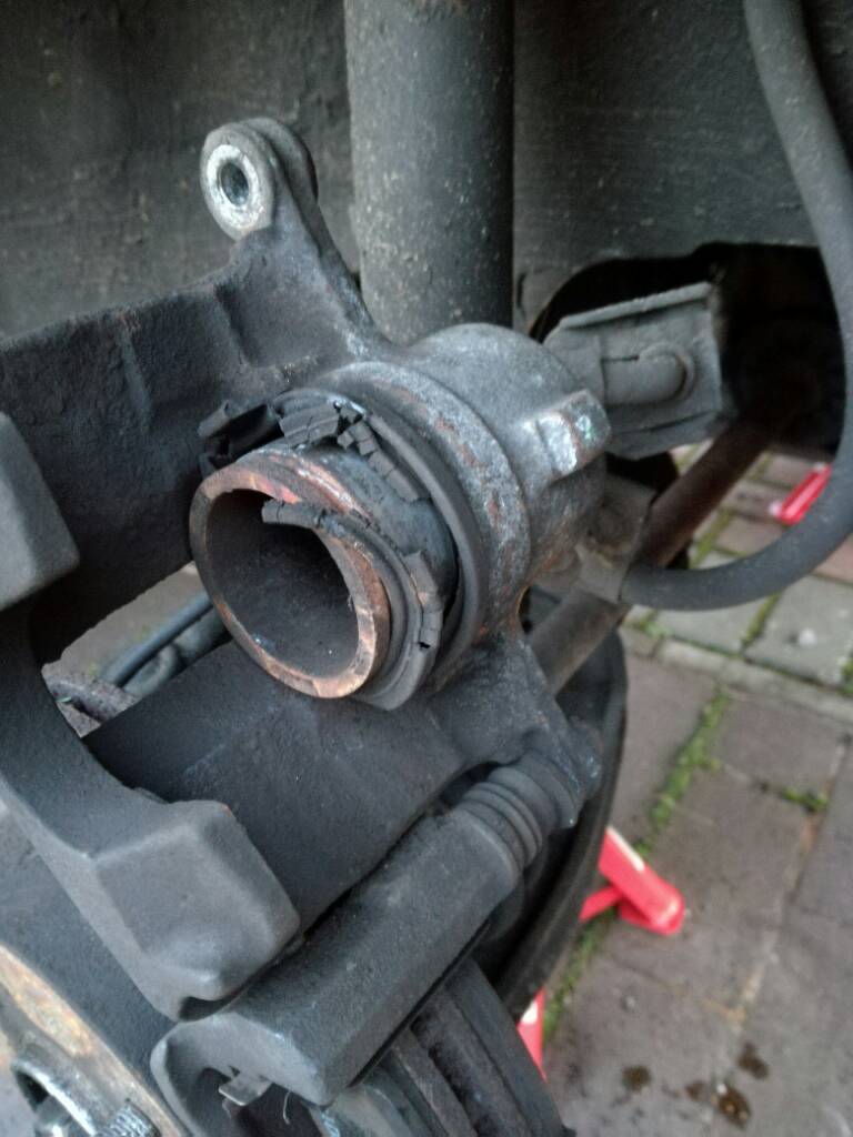

I have noticed something else that needs to be sorted urgently. Here is pictures
The disks are not scored but have a wear ridge of about 3mm, both at the edge and at the hub centre which effectively makes the disc about 6mm thinner. If you fitted new pads to those discs, initially they would only touch on the high spots on the edge and the centre.
I just changed the discs and pads on my K12 , new quality Mintex parts cost £40 (ebay supplier) and transformed the braking. As for the caliper dust seal, new seals might solve the problem (if you can get them) but be sure to thoroughly clean the exposed piston, BEFORE pushing it back into the caliper, with brake/clutch cleaner. Failing to do this will probably cause dirt/grit to be carried into the caliper bore and consequently damage the caliper seal.
When they are like this?
Seriously I'd get yours replaced, disc too :) it's the difference between stopping and crashing!!
if the pad is 2-3mm thick and or the material has broken away, it needs replacing.
measure the discs thickness.
if the thinnest section is 17-18mm, it still has enough meat left. minimum is 16mm.
if the disc face has severe rippling scoring and the edge of the pads have left a radius lip, either have the disc remachined flat or replace the discs before fitting the new pads.
damn that piston boot has been obliterated. imo the caliper will require an overhaul. take out, clean & inspect the piston closely. if the chrome plated sealing surface is degraded in any way (chrome chipped off or rusted), replace the piston & seal.
while replacing the piston boot, you may as well get a full caliper service kit for £8-10 to replace all the rubber components/seals tbh.
clean & regrease the sliding guide pins only with non-petroleum lube like Red rubber grease so the rubber doesn't swell & seize.
if it's too much work, could get a new or used caliper.
