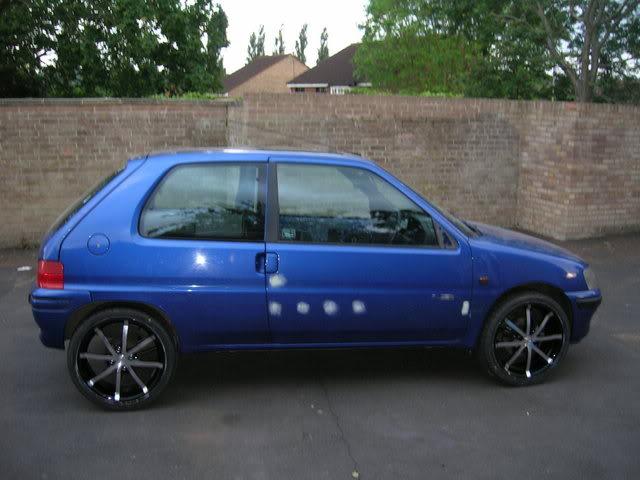

I would like to no what the biggest right size wheel to put on my micra k11 1995
Because I have 17" with 205/40/17 tyer and the Front have space on it
turne like a truck and rides rough so what the right size wheels ?

Only 17s?
I run 13s
13 and 14 were standard micra sizes, 15's are ok but I agree with stani that 14's are best, good tyre sizes in 14 (185/50, 195/45, 195/40) that get you either very close to stock rolling diameter or smaller (for if you like lows/faster acceleration)
