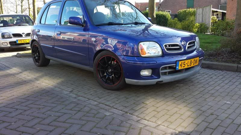

Just a general question what rim sizes do people have on there micra ? And what would the biggest size you would go be for the steering got to hard or hit the guards

195/40/16 on corsa coilovers.
(its not my car)

I have had 13s, 14s, 15s, and even 16s. 16s are brake cookers. 15s or smaller are good. be careful with coilovers with 15s i had to relocate my rear bumper mounts as it would shred tyres, other wise i could not full lock the steering. I was super super low tho.

If your talking about 15x7 -30 offset then no they won't fit under stock guards even if you roll them. Look at the post above you can see 15x7 +25 sit just about flush with the guards, -30 offset means you will be a further 55mm out from the guard. Try willtheyfit.com and go from there.
