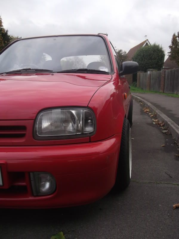

okay so i have been looking for my car which has a blog which is made by sr-steve called black 1.3 sr and i been looking a 6x13 and 7x13 :) but dont know which would sit flush with my car and whcih wouldn't stick out :)
the thing is that i have been looking at the fitments of the
the is the 6x13"
- PCD 4.101.6
- OffSet ET-0
the 7x13"
- PCD 4.101.6
-Offset ET-7
so i wanted to know would any of these fit the micra hubs ? this are offcourse minilites ;P but if any off them fit then it is a secret which you will have to look out on the blog :D

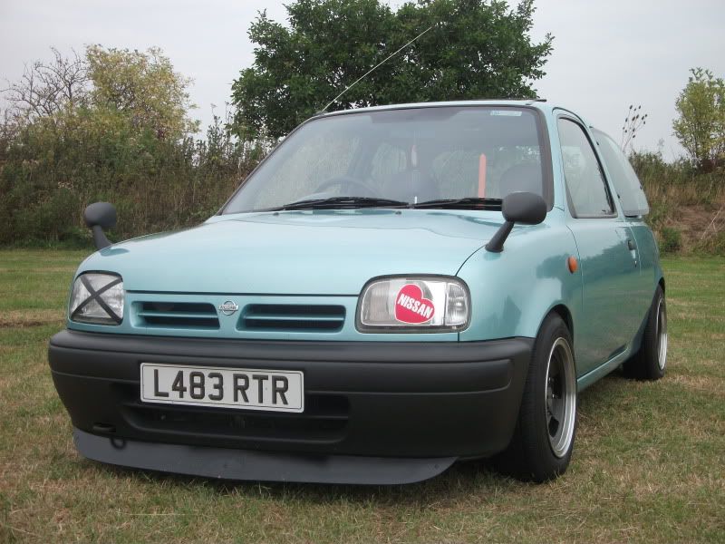

the 7"s will stick out around 20mm further out (half of 1" extra width + the -7 extra offset) You'll get a lot of poke from the 7" -7's.
Here's 7" on 0 offset, Your 7's will sit another 7mm out:
here's 6" on +13 (so the 6's will basically sit 13mm further out than these:
People have fitted 4x4" on 4x100 with regular nuts without problems. I'd prefer to use PCD correction (wobble) nuts and good centre location.
