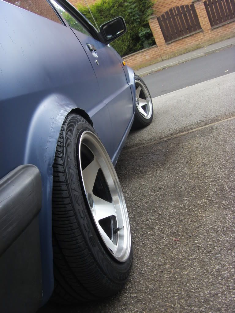

The picture is missleading because the car's black, the actual metal arch of the body is 2 to 3 inches further inward than the plastic arch covers. My red micra has that same illusion because i painted the arches and cills with underseal before i fitted the body kit, it makes the car look fatter though ;D . Gotta fight that rust!!! :grinning:
