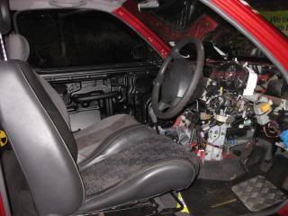

ye, best bet is aftermarket buckets with specific sub frames or like me, butcher some micra subframes and weld them to something else you like :D
I did have Primera seats for a while,only one fixing on the rear did not line up (tunnel side) & had to pack up the door side rear mount with a socket & longer bolt to make a good driving position...Comfortable but heavy!
You're unlikely to get any rears to direct fit but if you're keen you could try removing the fabric from the donor victim & fit to yours.Or just throw the back seats away ;)
i have bought the front buckets out of a scooby and had them welded to the original sub frame ( a lot easier on the wallet at 40 squid a pair)
