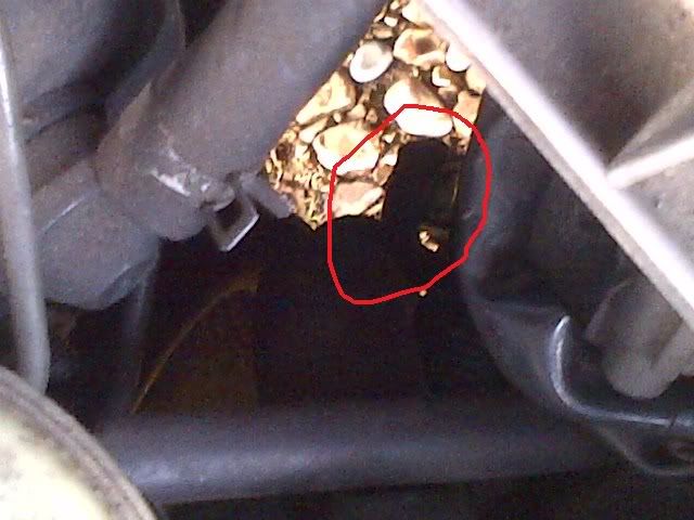

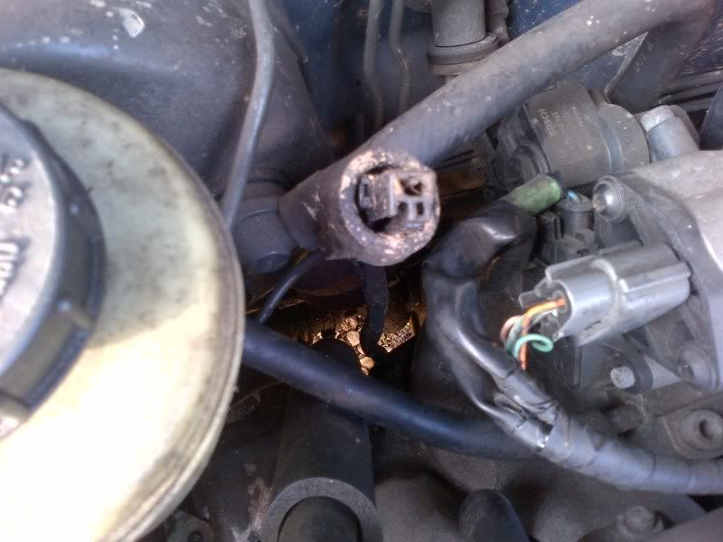

I was poking around my engine when my eye was drawn to a plug just hanging not connected to anything.
I found it hanging half way down the engine, at the back below the inlet manifold to the Right hand (Drivers) side.
Here are some pictures (First one is where is from the top not great I know, and the second is what the connector looks like when I reached down and brought it up)

That's interesting, the light isn't an at all, surely if it would be disconnected it wouldn't be on, as I thought oil pressure sensors work by providing an earth thus finishing the circuit and lighting the lamp. As my oil pressure light isn't on at all, in fact that's a good point I've never seen it.
Where is Oil Pressure switch on a K11, is it down the back in some inaccessible place?
Next to the oil filter, its easier to get to from underneath the car. It may turn out that when you plug it in the oil light stays on constantly, due to a fault with the switch. Hence why someone would disconnect it in order to sell the car. Years of watching columbo comes in useful some times :laugh:
Interesting I did jack the car up, saw the filter had a feel about couldn't find anything, I'll try and get a torch under there some time, but I suspect the connector has fallen off and they've left the cable off! Typical bodgers!
