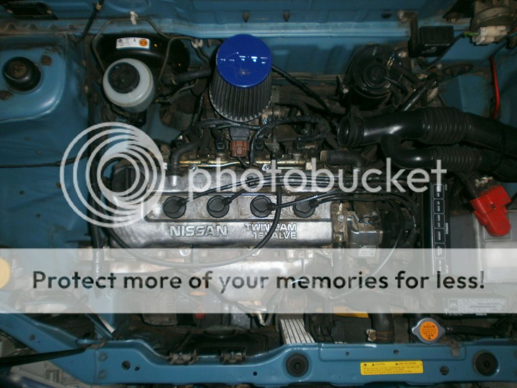

Finto_GX Jan 19, 2013 #1 Hi, theres a slight whine from my belts so im looking to get them changed. What belts do i need i have a 1997 gx with NO powersteering or air con. Fans are electric i think < pic of engine... thanks for any advice in advance.

frank Club Member Jan 20, 2013 #2 a 6pk675 for the alt, and a 4pk648 for the waterpump i believe finto (tho i bin the w/p idler and fit a 4pk613 on mine )

OP OP Finto_GX Jan 20, 2013 #3 what do you mean bin the w/p idler? Thanks for that will buy them tommorow
frank Club Member Jan 20, 2013 #4 Finto_GX said: what do you mean bin the w/p idler? Thanks for that will buy them tommorow Click to expand... idler-less finto and you,d best double check on ebay or whatever
OP OP Finto_GX Jan 20, 2013 #5 i dont understand what youve done there even with the picture? Should i replace the waterpump too?
