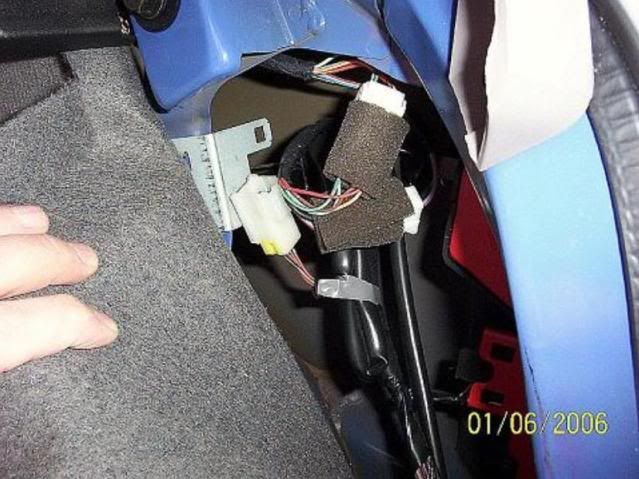

What are these connectors used for
There are two connectors in the pics shown one of them is live the one with
two connectors and one with four pins inside there off a nissan micra k11

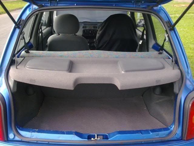

The first one with the 2-pin connector is for the boot light. The second larger 4pin connector is for the rear speakers like this one:
Some lower spec cars still have connectors for which you can 'up-spec' your car to fit these extras if they were not sold with them as new. Some options are simply plug 'n' play, many others are not.
Fitting OE spec rear speakers is simply plug 'n' play if you can find a rear Micra parcel shelf with speakers as the one above. I was lucky to find the one I have above in a scrappy.
The boot light is not plug 'n' play. You need some sort of boot lock mechanism from the higher spec cars plus the boot light itself and possibly a loom if one is not fitted. I'm still pretty flummoxed regarding the boot light despite it being sort of explained on a couple of other threads.

The one with 2 wire is located where?
The one with the 2 wires are locted near the rear speaker connectors, if its not on the small protuding prong seen in my second pic where the speaker connector is hanging from, then it might be hanging down somewhere near the rear light.
