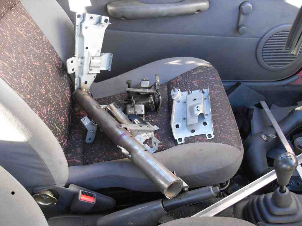

Do you honestly believe that removing the front impact bar from under the dash, or grinding the drums down so they will possibly crack the first time they heat up isn't compromising safety?????

Hahahahahaha your ignorance humors me. I think the bar near the steering wheel is just a support bar and all of franks work is fabricated to top standards. The rear drums are not ground down on any structural part.

Look at the thickness of the bar from under the dash, pretty sure thats not just there to hold the dash up...

I would say this is bordering on dodgy. The drums are made to that thickness specifically for cooling reasons, not because they couldn't be bothered to cut the extra metal off. That thick metal bar is thick and metal for a reason. They would have made it thinner and lighter to save money if it didn't need to be that thick.
I watched a great video once where this guy basically stripped the crap out of a brand new car, insanely worse than what Frank has done and they kept measuring its quarter mile performance after every round of weight reduction. Basically its the law of diminishing returns. You strip more and more important stuff from the car and you end up with a piece of **** that rattles and is quite unsafe, and your quarter mile time improves by half a second - so what. And you have to do a mighty lot more than what Frank has done, to achieve that half a second.
Basically you are much better off with a safe car that has trustworthy brakes and safety components and just adding more horsepower. But when I was 18, I would have been in full support of Frank saying "yeah wow way to go man!!!!".

Could be that thick to deal with any forces from an air bag impact as some micras came with them I think?
I can see that the bar may be a touch on the excessive side but the other mods would all be fine.

Personally, I'm with Tyrie and Cisco on this one. The micra already has barely a 1-star safety rating. I'd trust the Nissan engineers' decision on the components rather than using a bunch of aluminium L-pieces and square tubes put together for 'weight reduction'.
Normally I'm a fan of your work frank, but to me this stuff screams out 'risk enhancement' more than weight reduction.

here,s a few extra hp hopefully, a cut-n-shut oversize cat exit/flange and 45mm exhaust system :)
and referring back to the steering column support, nissan designed it to only go 1/2 way across the car and then a flat bracket down to the tunnel (aimed at your left shin !)
had they designed it to run right across from the left A pillar to the right A pillar they would,nt have had to over-engineer it out of scaff pole ffs
my "replacement" column support bar runs across the full width of the car, adding a little bit of side protection, and i have no sharp brackets around my legs :)
