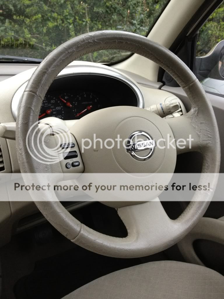

The controls on my steering wheel look like this

As far as the wheel controls none of them function.
Have not checked if this part is wired.
For me these controls are a mystery still.

You need a radio That has a steering remote in And a steering remote converter. With That you can connect the steering controls to the radio And make iT work.
